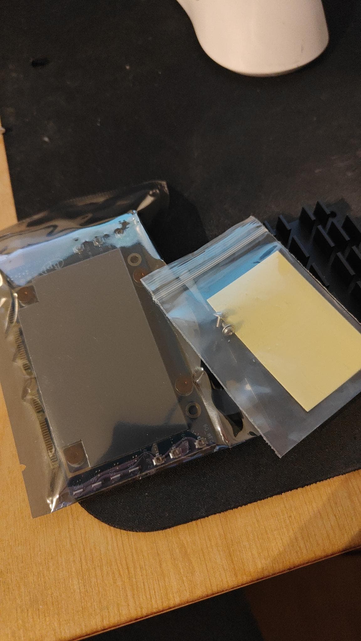

hi, i am just installing the r4 pro in the case. two questions:
this yellow cooling tape, i assume it should be used between be14 and heatsink? because its a bit smaller than the plate.

As the other comment says, those fans for the case will work perfectly. For the BE14 v2 card I’m using the heatsink with fan from the BPI shop (I’m guessing yours is the one without the fan) - this one the heat sink is actually bigger than the card.
Mine didn’t come with a heat pad (like the one in the picture) so I simply put thermal paste. YMMV but mine It’s been working for several weeks without issues.

That yellow thermal pad is used to conduct heat between the BE14V2.1 module and the heatsink; you can go ahead and install it with confidence.
