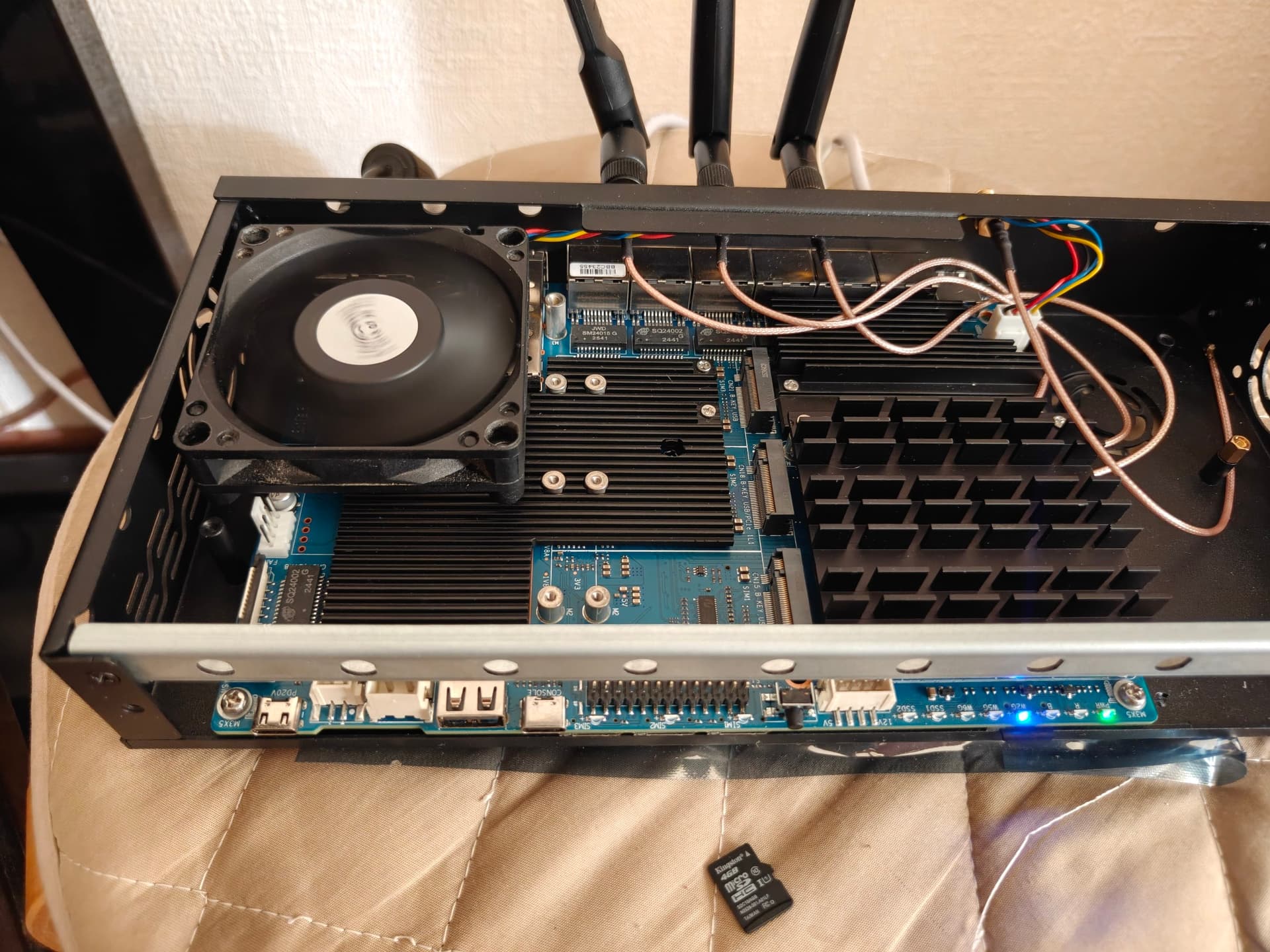

I am reaching out for help with a serious issue on my Banana Pi BPI-R4 Pro 8X board, which I received just 5 days ago.
The core problem: The board does not boot on its own with any firmware. I have flashed firmware to both eMMC and SD card — the result is always the same. Without connecting the console cable (Type-C UART), the boot process does not proceed. The board hangs at the preinit stage indefinitely and only continues booting after the cable is plugged in.

Additional symptoms: The fan starts running immediately after power-on. Its speed can be changed using echo 50 > /sys/class/hwmon/hwmon2/pwm1, but echo 0 > /sys/class/hwmon/hwmon2/pwm1 does not turn it off.

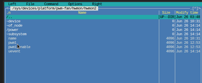

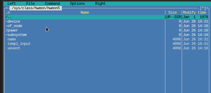

What can I do about the fan? It won’t turn off. The speed can be adjusted from max 255 down to min 1, but at 0 it keeps running. echo 0 > /sys/class/hwmon/hwmon2/pwm1
You can try this command: echo 0 > /sys/devices/platform/pwm-fan/hwmon/hwmon5/pwm1. You can also change the enable parameter to disable it.

There’s no parameter for it in hwmon5, but I’m using non‑stock firmware. On the stock firmware, MT7915E doesn’t work. As for the fan, (echo 0) is ignored — the speed stays at minimum and it never stops.
echo 1 > /sys/devices/platform/pwm-fan//hwmon/hwmon2/pwm1_enable
pwm1_enable = 1
echo 128 > /sys/devices/platform/pwm-fan//hwmon/hwmon2/pwm1 (speed 50%)
echo 100 >/sys/devices/platform/pwm-fan//hwmon/hwmon2/pwm1 (speed 30%)
echo 10 >/sys/devices/platform/pwm-fan//hwmon/hwmon2/pwm1 (speed 3%)
echo 0 >/sys/devices/platform/pwm-fan//hwmon/hwmon2/pwm1 (speed 1%, and do not stop)
