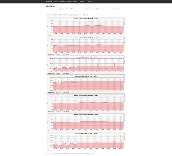

Any hints in dmesg? Have you looked on temperatures? I did not make much loadtests because i have no heatsink yet and only fan standing next to the board sometimes.

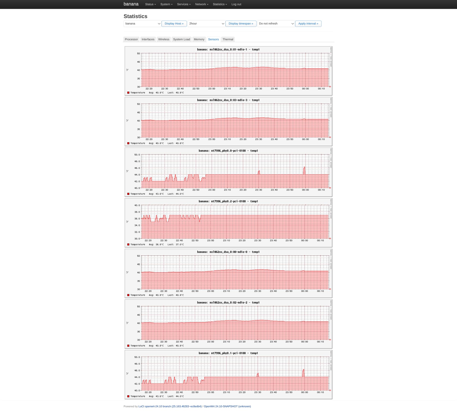

temperatures:

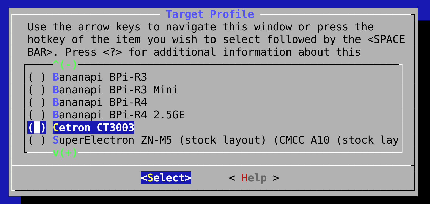

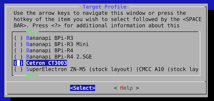

there is no target profile for BPI-R4-PRO:
Afair there was a special doing for R4Pro, could be different now.
https://wiki.fw-web.de/doku.php?id=en:bpi-r4pro:start#openwrt
not sure if you can add the patch there
