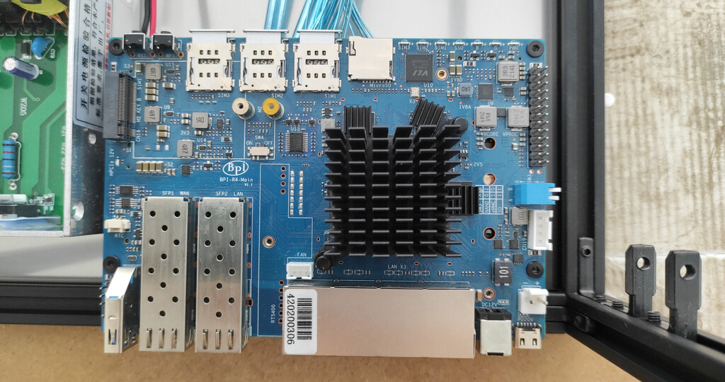

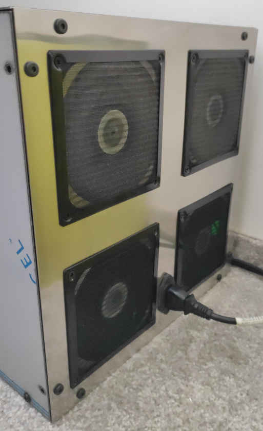

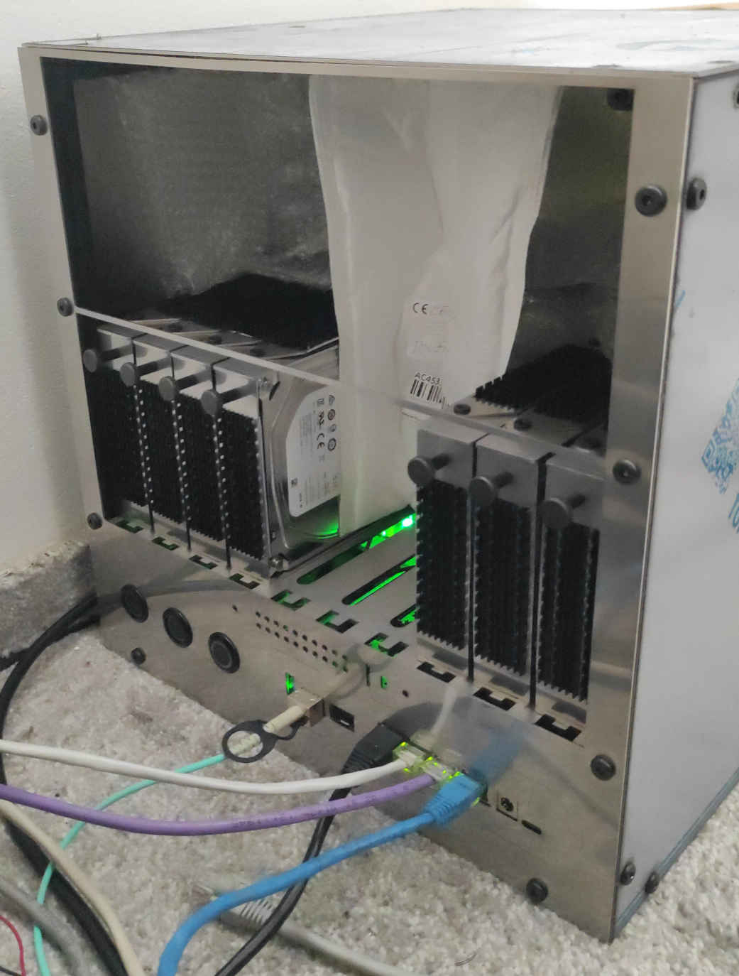

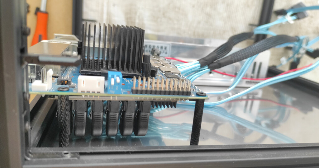

As we are solving issues here, I decided to post some photos of “what the hell I am working and talking about”… As i wrote already, I designed and manufactured custom case. This is the very first manufacturing effort, and as You can see, without m.2 B key sata controller, and only lower 10 hard drives positions are used.
I have to get all actual images where is the m.2 B key sata controller installed and therefore the upper 10 hard drives positions available, upgrades of the internal cable management, and of course installation of the heatpipe cooling solution, etc… More actual photos will be added soon.
