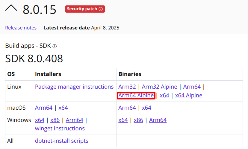

First, OpenWRT must use the Arm64 Alpine version of .NET Core.

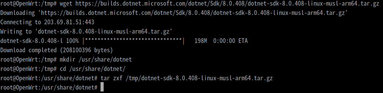

Download .NET Core From Microsoft
wget https://builds.dotnet.microsoft.com/dotnet/Sdk/8.0.408/dotnet-sdk-8.0.408-linux-musl-arm64.tar.gz
- Mkdir /usr/share/dotnet and decompress .NET Core
mkdir /usr/share/dotnet |

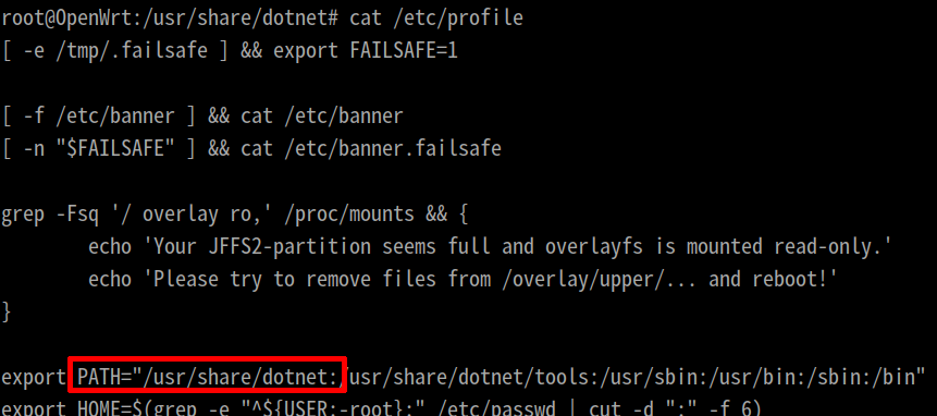

- Modify /etc/profile and add /usr/share/dotnet to PATH

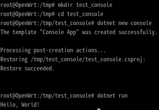

Test console project:

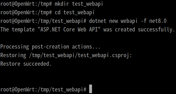

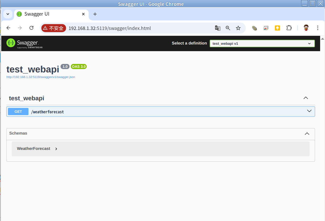

Test webapi project:

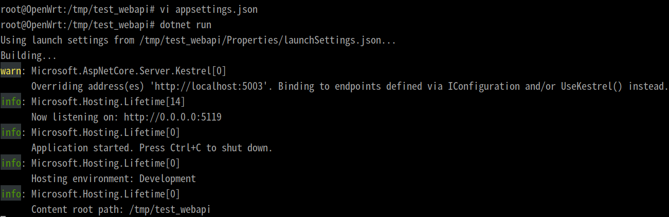

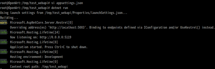

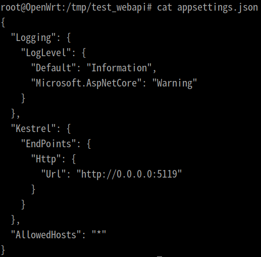

Modify appsettings.json, change binding localhost to 0.0.0.0.
Run it.

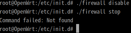

PS:
OpenWRT has a firewall enabled by default, which will cause the webapi server unable to connect.
I only use it(OpenWRT) as a WiFi AP, so I turned off the firewall.
