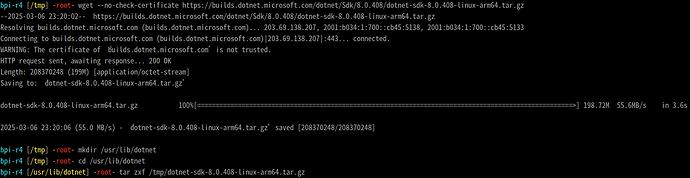

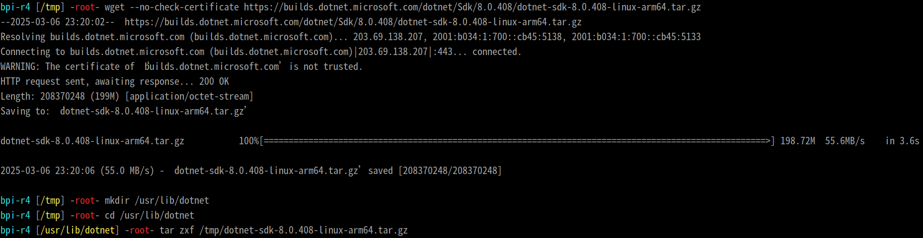

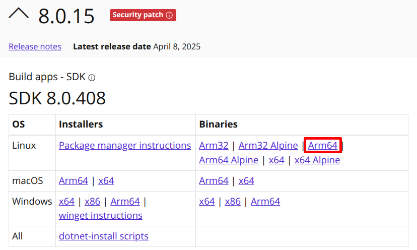

- Download from Microsoft .NET
We download Arm64 version Binary.
- Mkdir and decompress .NET to /usr/lib/dotnet
cd /tmp |

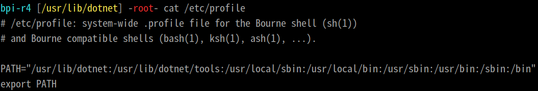

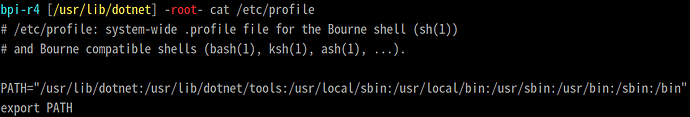

- Modify /etc/profile and add /usr/lib/dotnet to PATH

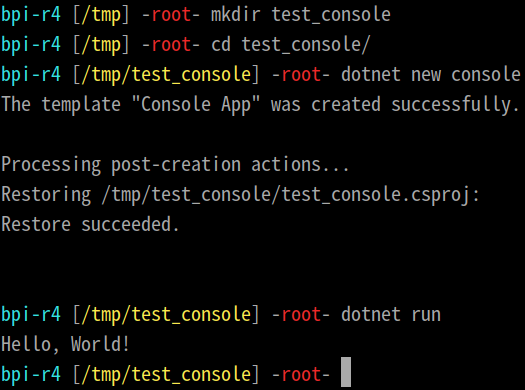

After installed, we can create project to test.
Console project test:
mkdir /tmp/test_console |

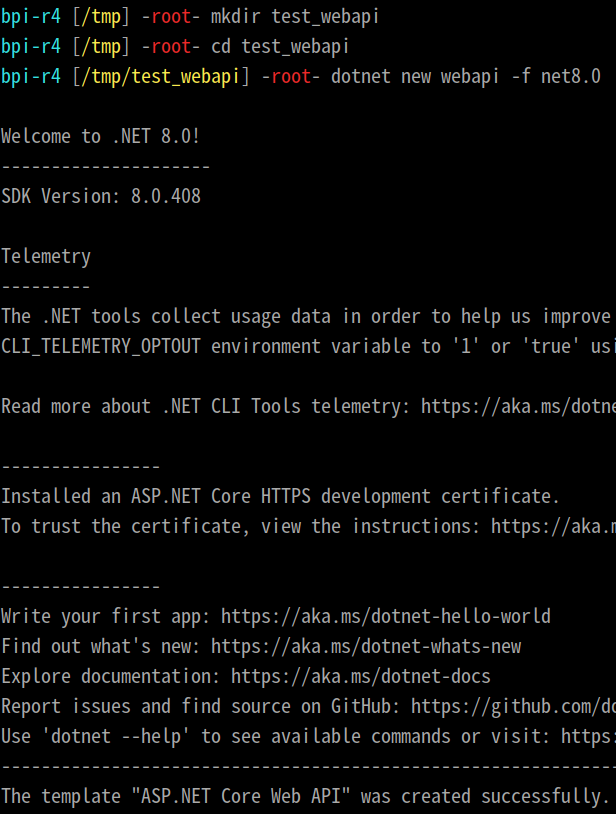

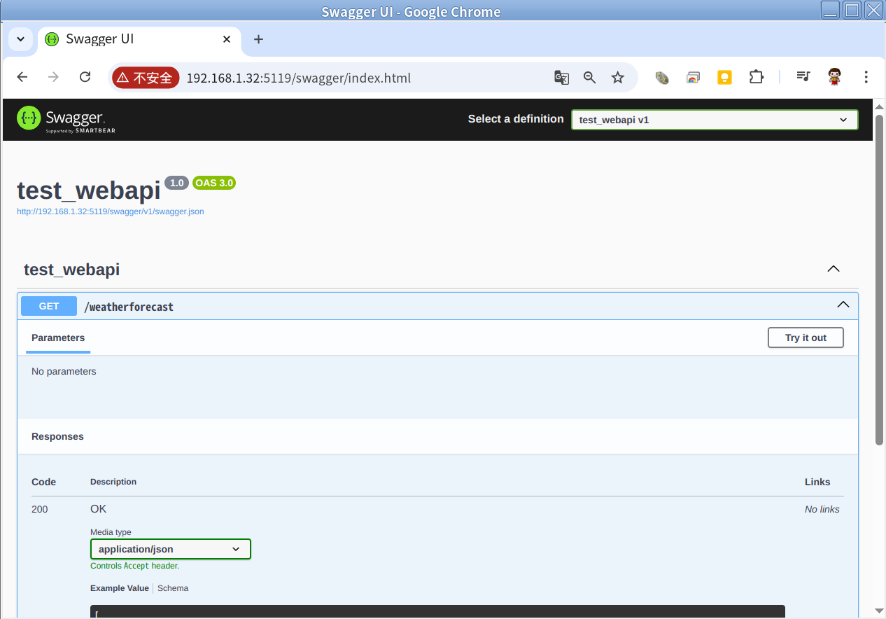

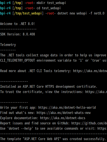

API Web project test:
cd /tmp |

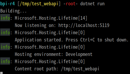

dotnet run

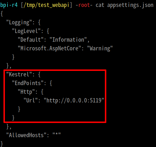

PS: .NET webapi default binding localhost, we can modify appsettings.json to change this.
