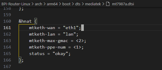

The r4lite uses eth1 as WAN interface, so we need to add new network setting specifically for it. Otherwise, the WAN port does not work as usual.

Yes, we need the eth1 config such as the 06-eth1.network above for bpi-r4lite.
The current setup (r4lite board runs r4 config) does not work for WAN init.
It may need to be separated from r4.
