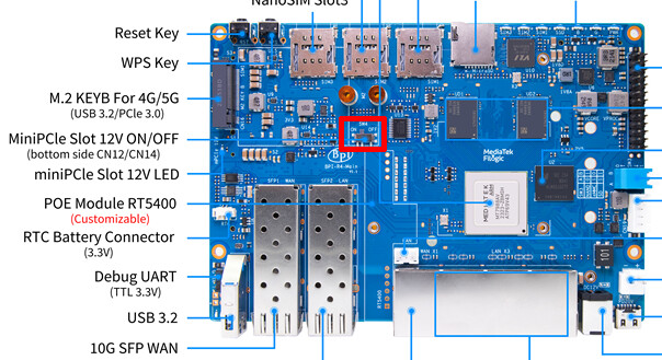

I bought a realtek r8125 mini-PCIe 2.5Gb NIC for testing.
First of all, changes SW4 to OFF.

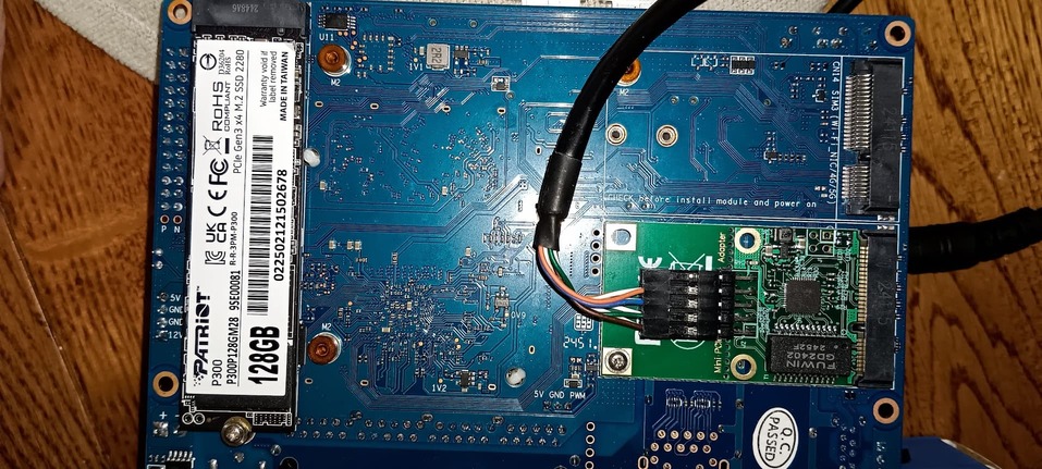

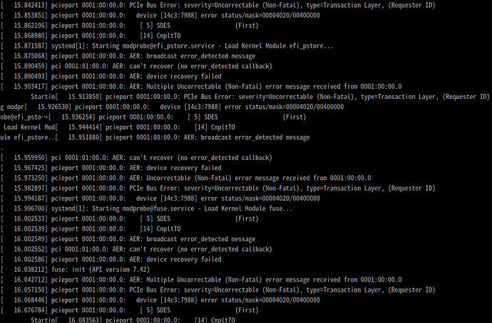

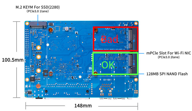

I tested the NIC by inserting it into two mini-PCIe slots and got the following results.

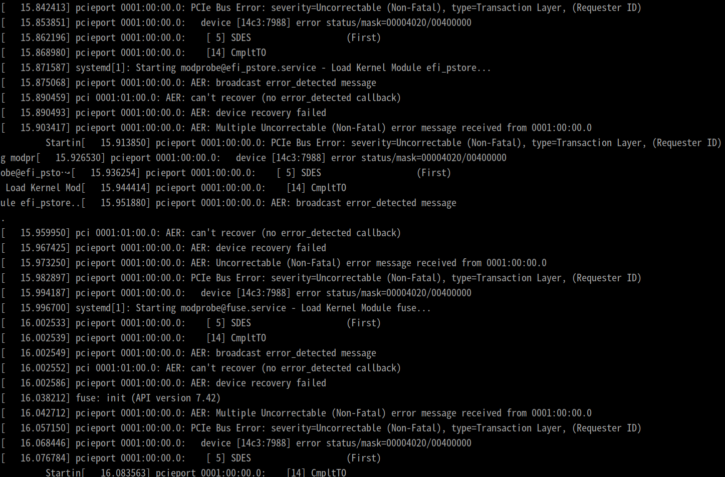

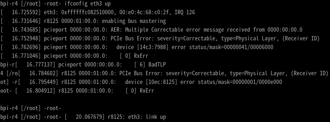

When I plug it into the upper slot and turn on the BPI-R4, the following error message appears in a loop until Kernel Crash.

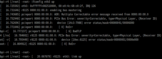

When I plug it into the lower slot and turn on the BPI-R4, it looks OK.

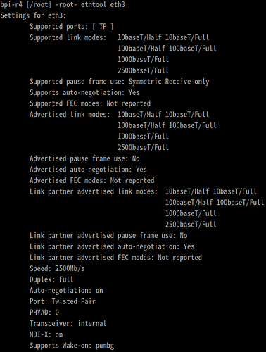

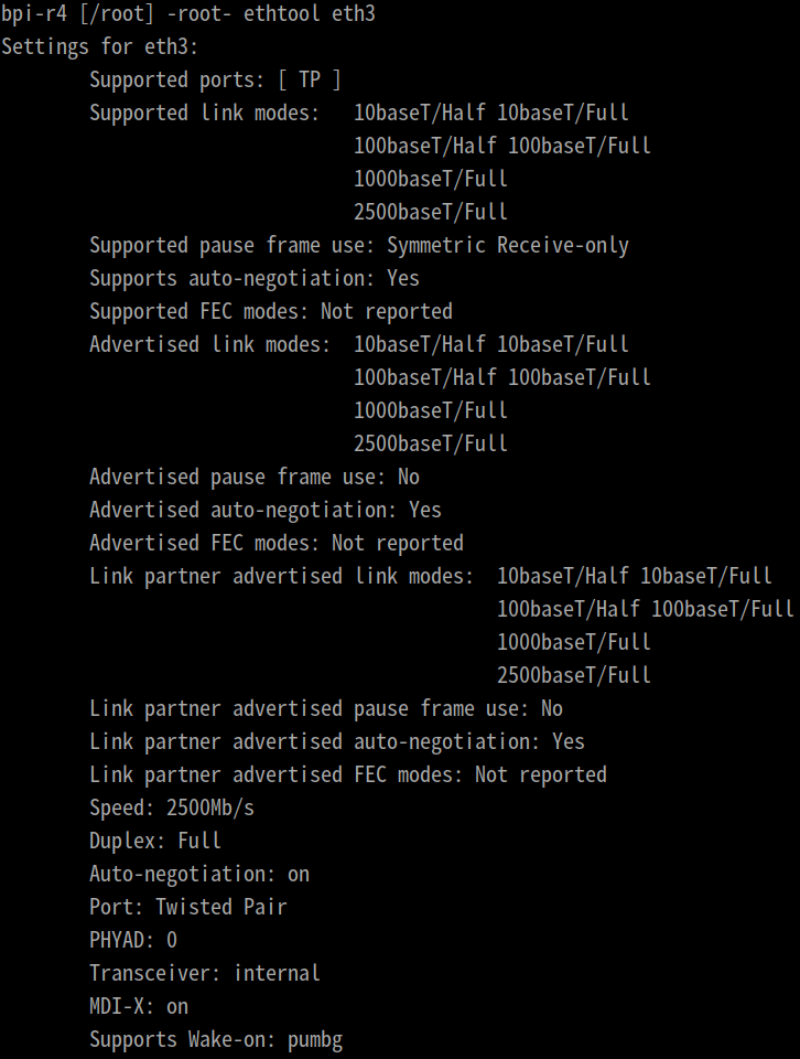

Then after I loaded the r8125 module, the eth3 network interface appeared.
ethtool show:

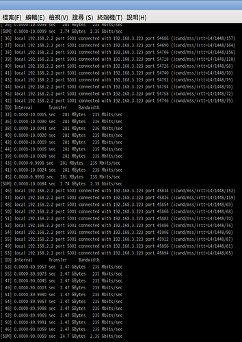

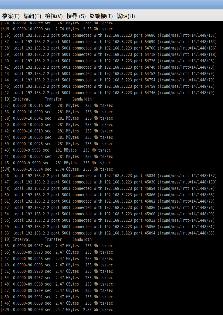

Speed Test:
It looks OK, no watchdog timeout, no nic crash, network speed is also stable.

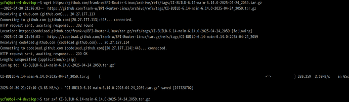

Download and decompress frank-w kernel source
Now release: CI-BUILD-6.14-main-6.14.0-2025-04-24_2059, Download Source code (tar.gz)

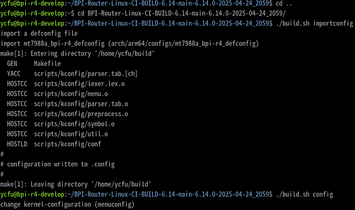

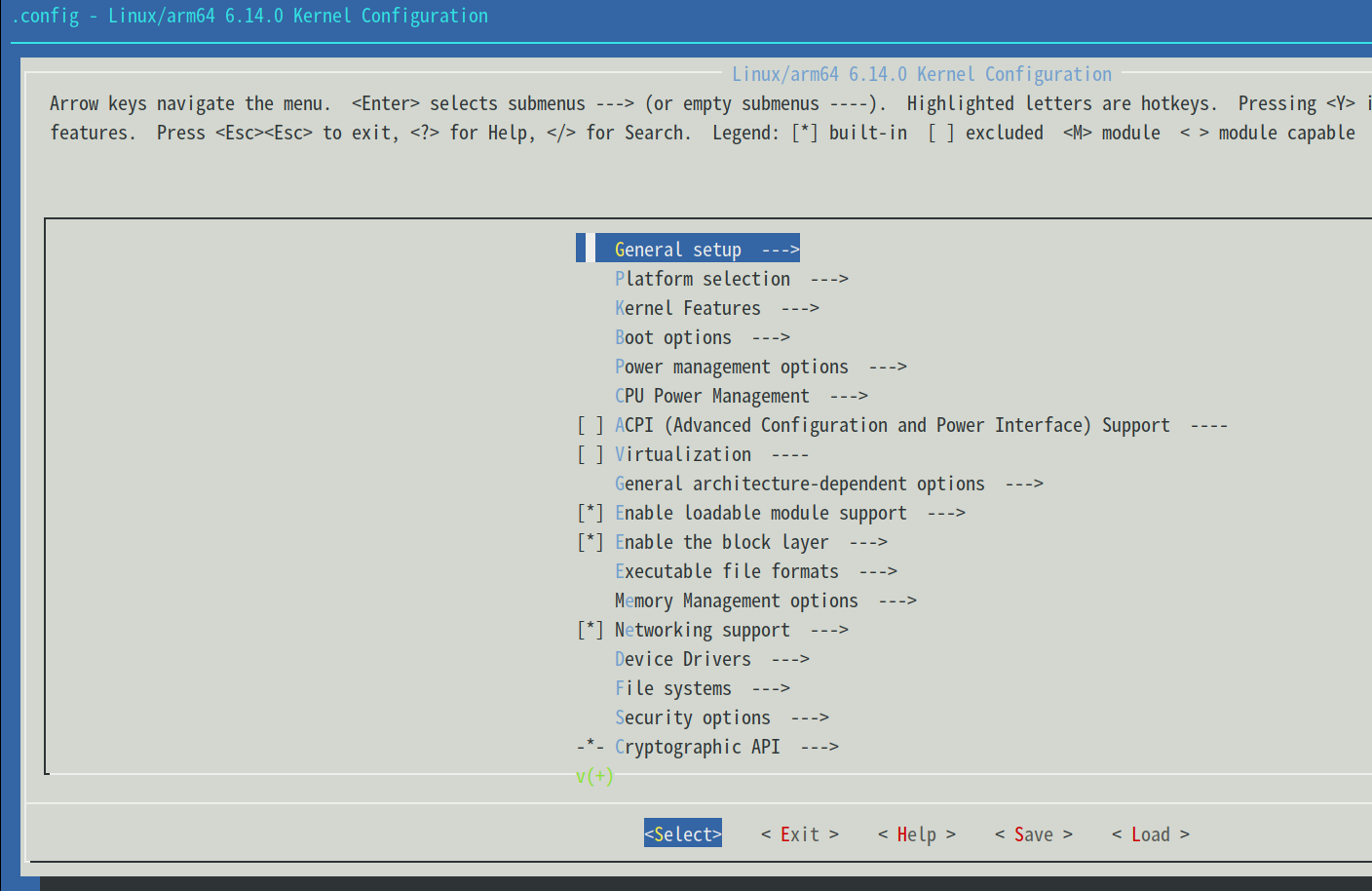

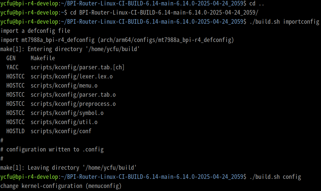

Import default config & custom config
./build.sh importconfig
./build.sh config
If we want to use the default values, we can just click “Exit” and “Save”.

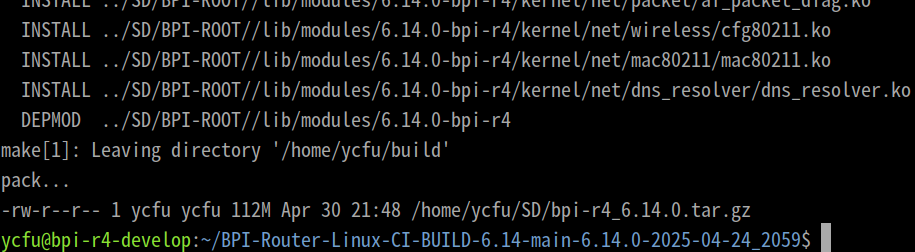

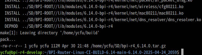

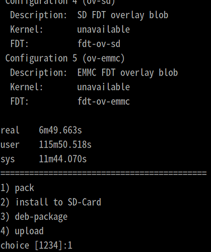

- Build Kernel
./build.sh
At the end of the compilation, we select 1 to generate compressed archives of the kernel image and kernel modules.

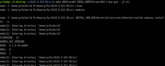

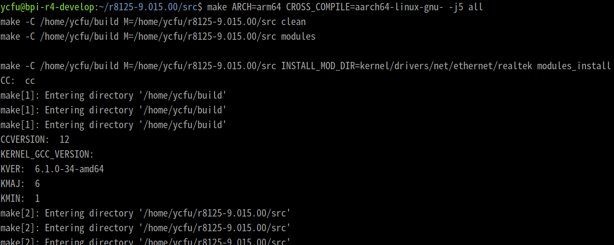

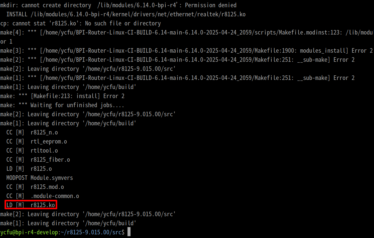

Build it
cd r8125-9.015.00/src make ARCH=arm64 CROSS_COMPILE=aarch64-linux-gnu- -j5 all

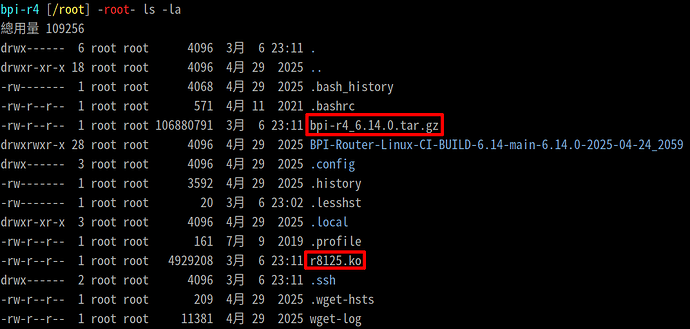

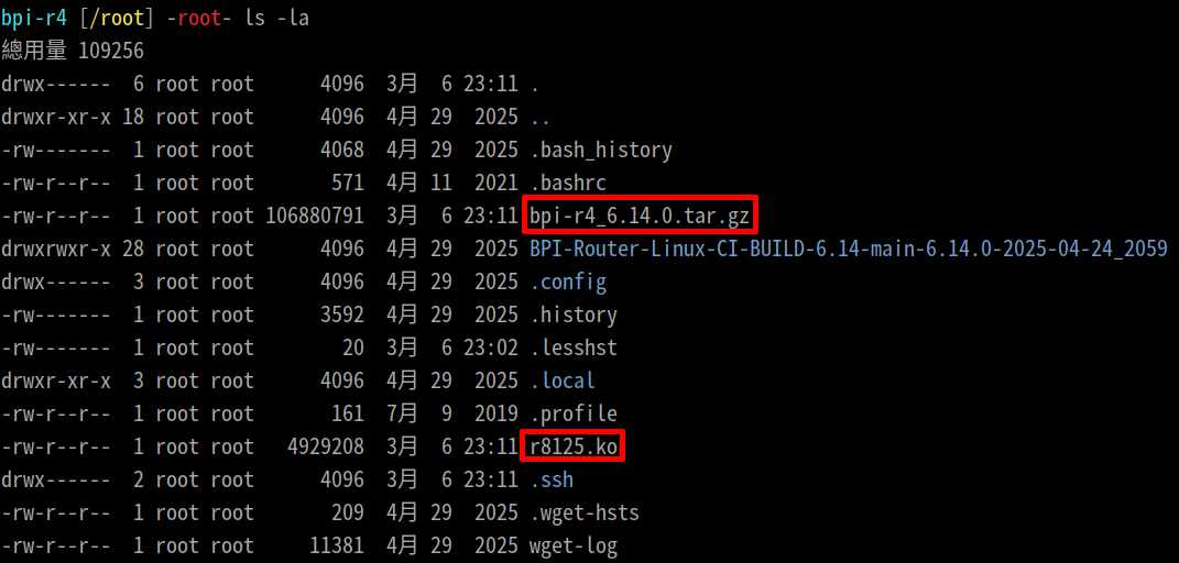

Install kernel image & kernel modules & r8125.ko to BPI-R4

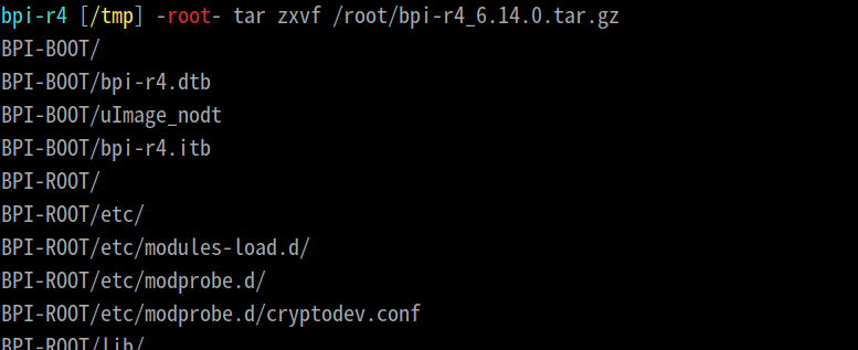

Decompress bpi-r4_6.14.0.tar.gz
Copy(or Move) BPI-BOOT/* /boot/
Copy(or Move) BPI-ROOT/lib/modules/6.14.0-bpi-r4 to /lib/modules/
Copy(or Move BPI-ROOT/etc/modprobe.d to /etc/
Copy(or Move BPI-ROOT/etc/modules-load.d to /etc/
Copy r8125.ko to /lib/modules/6.14.0-bpi-r4/kernel/drivers/net/

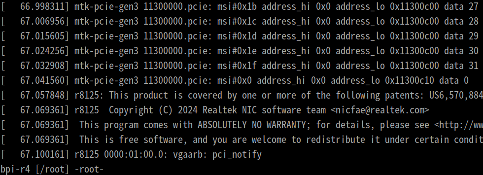

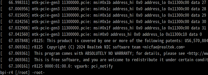

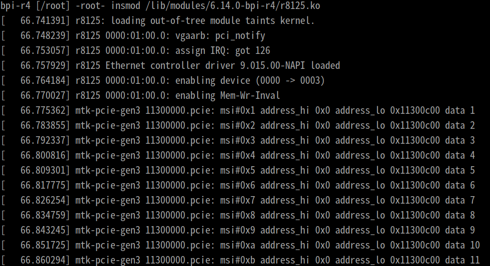

insmod r8125.ko to testing
Looks good.

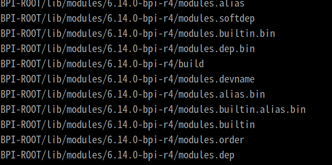

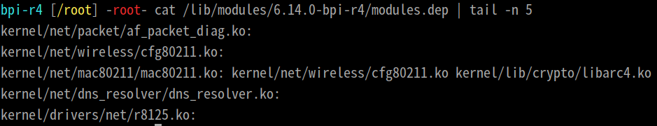

We add r8125.ko to modprobe
Modify /lib/modules/6.14.0-bpi-r4/modules.dep
Add “kernel/drivers/net/r8125.ko:” to the end.
Execute “depmod -a”

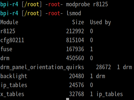

- Use modprobe to load r8125
modprobe r8125
lsmod

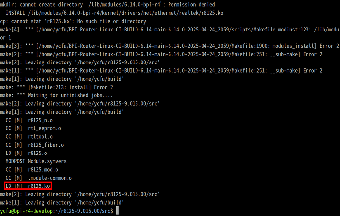

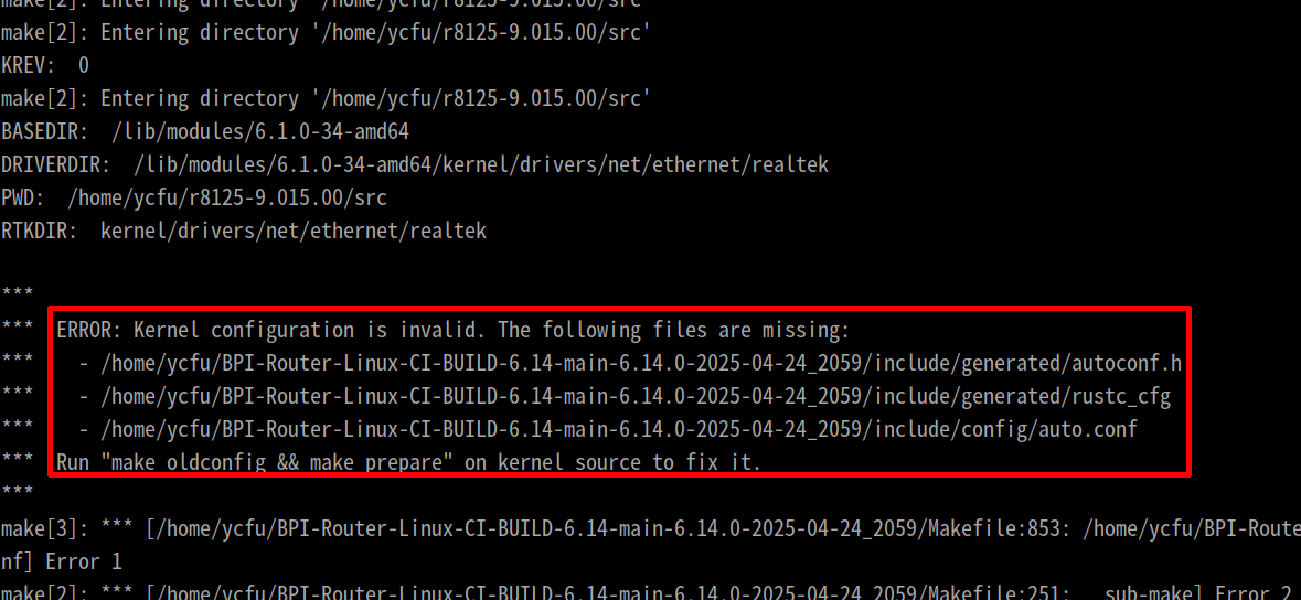

When we build r8125 module, if we got error message:
This is because when compiling r8125 module, the compiled file of the Kernel could not be found.
When we compile the kernel using frank-w kernel’s build.sh, it will create a build folder in the home directory (here is /home/ycfu/build).
All kernel compiled files are in this directory.
Therefore, when compiling r8125, make sure that the specified Kernel source is this directory.
