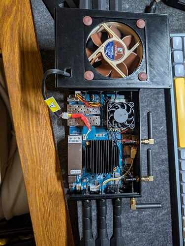

I’ve modded my BPI-R4 to add a secondary fan for WiFi module cooling. Connected PWM signal to the PWM6 channel exposed on the GPIO header. Works good so far if I manually setup pinmux/PWM, as I’ve noted above. Can control it that way via user-space daemon, but would prefer to have kernel hwmon module to manage it. Straight approach is to add required nodes to the device tree, but I’m looking for a way to be able to stick with vanilla OpenWrt kernel/images. Maybe there is a way to add a kernel device tree overlay outside of the FDT image? Or create a new nodes from running OS, or maybe add a new hwmon/thermal zones, not included in the booted device tree.

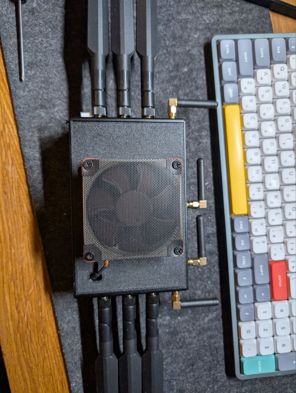

When I was ordering my BPI-R4, I wasn’t sure if the official metal case would be good. Read some rumors that it might be have issues with cooling due to a tight spacing and lacking a design for cooling the bottom part with WiFi board. So I’ve decided to start with a cheap acrylic case I got for ~$3. Turns out it was an option because it seems to have slightly more spacing on the bottom between the board and I could fit 7mm height fan. But not right under the wifi board, where only ~5.5-6mm spacing remains. There are tiny coolers as low as ~3mm available, but they are pretty small in other dimensions, so I did it the other way. I’ve ordered a copper heatsinks for Orange Pi 5, which are ~5mm, and 3 out of 4 in the pack sold have dimensions almost matching dimensions of the chipset ICs. Somewhere around $3 again with shipping.
And ordered a 3007 (30x30x7mm) blower fan, with side-out flow again for the $3.
It “catches” air from the front side relative to this picture and blows it out to the left edge. So I’ve installed heatsinks on the ICs and attached fan on the bottom housing plate, slightly before the edge of the WiFi board where it can fin. With the flow out directed towards the installed heatsinks. 30mm side doesn’t covers all 3 completely, but still good at cooling all of them as air get dissipated while hitting the center heatink.
Had to drill a hole in housing for the fan air intake. Used a screwdriver with a conic drill. I’m not good with a “handcrafting skills” so ended up with 1 crack but I don’t care as it’s the bottom part which is not seen anyways and it’s still solid and didn’t lost much of the integrity from that crack. Most likely if drilled slower, and applied less tension it would have turned out more neatly. But as I’ve said - I’m not good at it and I’m just fine with the result. Fan are attached with a M1.4 self-tapping screws straight to the housing.
I’ve reversed direction of the hex stands included with the case, so that the rounded “caps” become a housing “legs”, adding some space below it for air intake. Should probably add some dustguard as well but mine are currently seating in a pretty clean environment so I don’t bother for a while, will add it some days later once I’ll find something suitable.
Had a readings of ~67-68 *C from the WiFi module on the board without casing, i.e. open (at the room temp of ~24*C). Without a load, but all 3 APs running. Same environment and conditions but having it inside the housing and aux fan running gives me ~41-42 *C, which I consider could call a success.

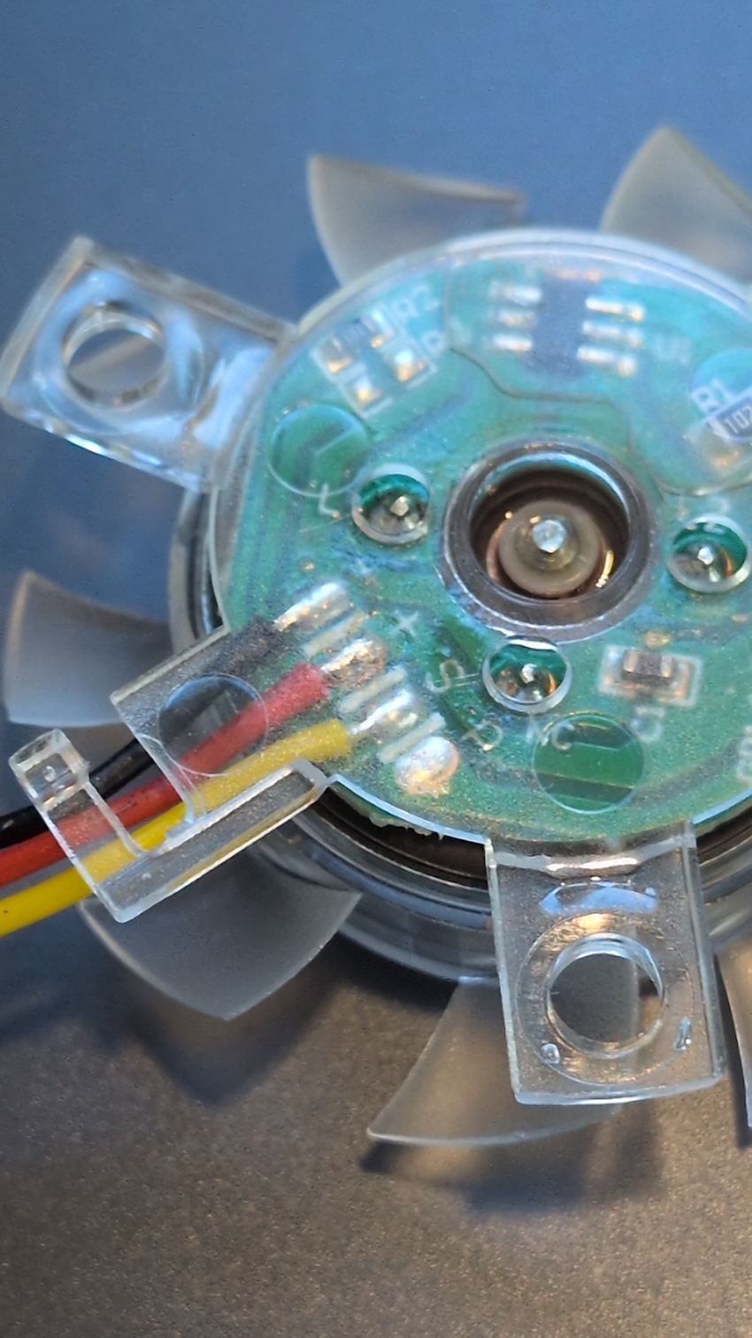

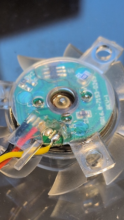

Hi. Recently i started using my brand new BPI-R4. As i ordered only the bare board (the 8GB revision), i also ordered some heat sink with a fan (the cheapest - as usual) on Aliexpress. I have chosen the following fan from the seller Electree Store.
The fan was running at 100% only, regardless of the PWM setting. I started to read the forum, tinkered with the OS and software - nothing helped. Yesterday evening i pulled out my oscilloscope and what do I see? Some nice, proper PWM signal on the PWM pin…
I went to the Aliexpress website and wanted a refund - 2 days too late. I left an angry 1-star review and called it a day.
Today, when storing my oscilloscope i felt the urge t to take a look at the fan itself. See the picture yourself… take a close look…
Yeah! Those bozos soldered the PWM cable to the sense contact (‘S’)! After a little hackish soldering the fan works fine. So - when you ordered a heat sink with a ‘transparent’ fan marketed as a “BananaPI BPI R4 PWM Fan” and it’s not working properly - have a look at the wiring/soldering.
FYI - the encasing of the fan seems to be hard/impossible to disassemble, so i chipped off some of the plastic with a small side cutter to expose the pads, because i had the impression that anything else would break the fan entirely.

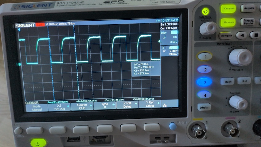

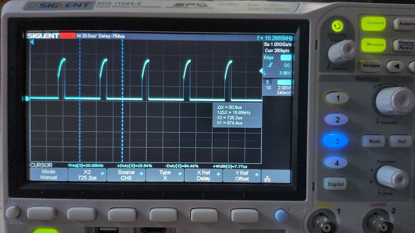

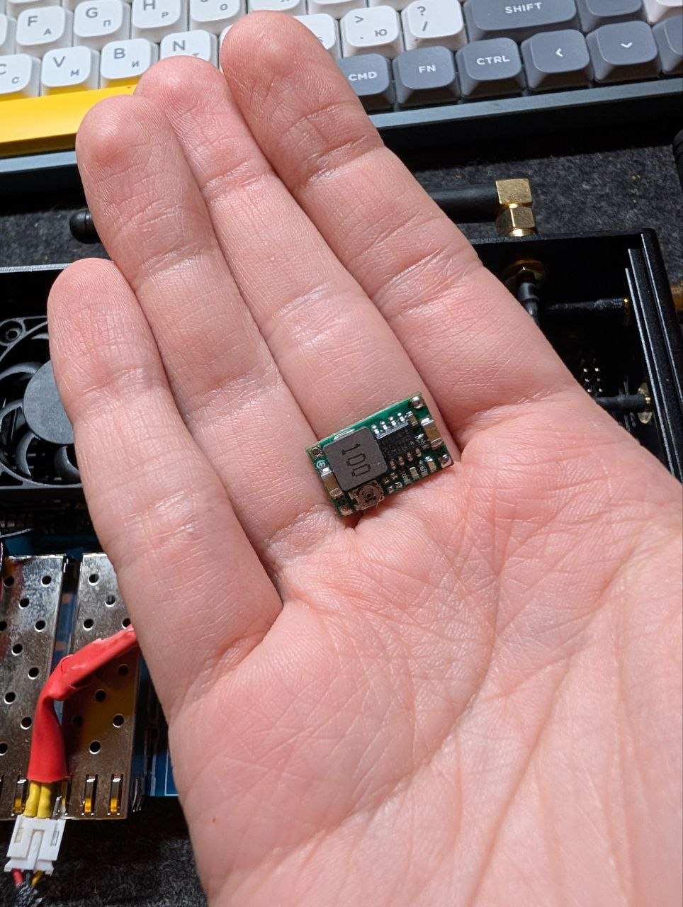

Hello, I have solved the cooling problem based on the example from the messages above. I’ve finalized the idea and tested it, and now I’m ready to share it.
I decided to make the mode silent, so I made DC 3.9V - this is enough for cooling and a little noise. I do not recommend using the standard 3.3V, because the cooler is running at a minimum and there is no cooling. I managed to achieve an angle of 40 °
I’m attaching a 3D printing model of the panel that you see in the picture. CoolPanelV2.3mf (215,3 КБ)
