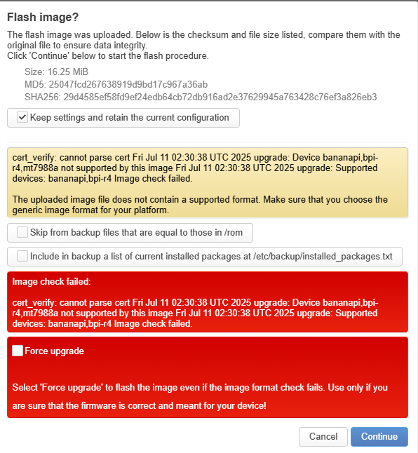

BPI-R4 Can't Upgrade to OpenWrt 24.10.2
I downloaded the update image from the OpenWrt web site but when I upload the file to my router it tells me that “image check failed” as can be seen below
Why is this happening and should I just tell it to force upgrade?
