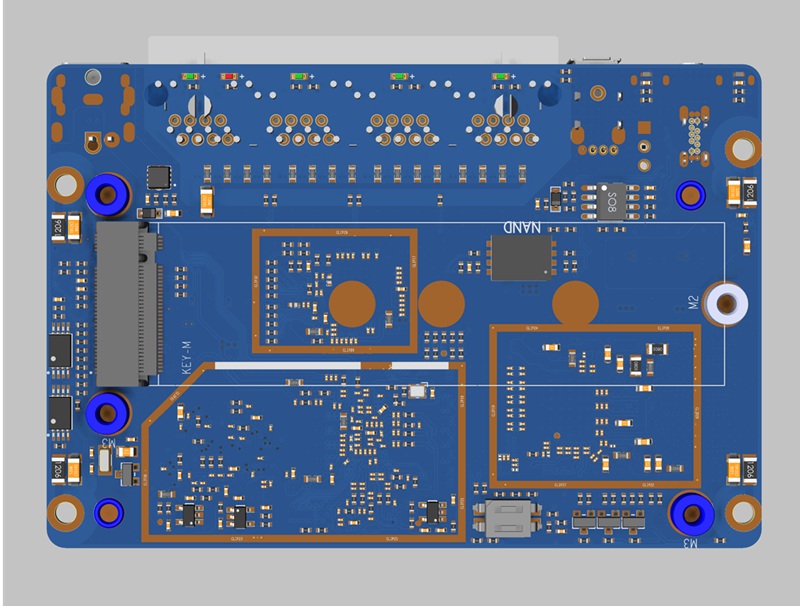

  • It’s good to place the M.2 Key-M on the underside again :+1: (I found it a very bad decision on the R4 Lite to place PCIe modules above the CPU :melting_face:)

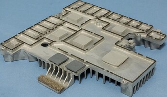

  • Shielding & cooling: you’re already building a good cooling solution—very close to what I want! If you want to avoid cans, use a full-metal shield with foam:

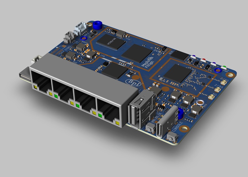

size is 97mm x 65mm, and 4 RJ45, other is same as Openwrt one,We will try our best to make it compatible with the Openwrt one software. and now just support SSD ,not support 5G ,if you need 5G support ,you can try BPI-R4 Mini.:slight_smile:

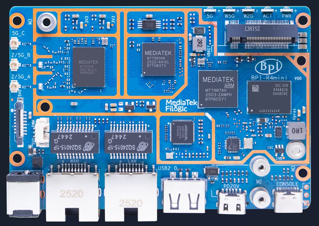

any specs or 3D pictures for the new bpi-r4 mini?
Hi,
The hardware specifications remain largely unchanged: 256MB of SPI NAND and a small SPI NOR, plus 1GB of DDR4 memory.
Hi, thank you for your suggestion!
This is the R2mini, based on the MT7981B’s 2.4G/5G Wi-Fi 6. There will also be an R4mini, based on the MT7987’s 2.4G/5G Wi-Fi 7.

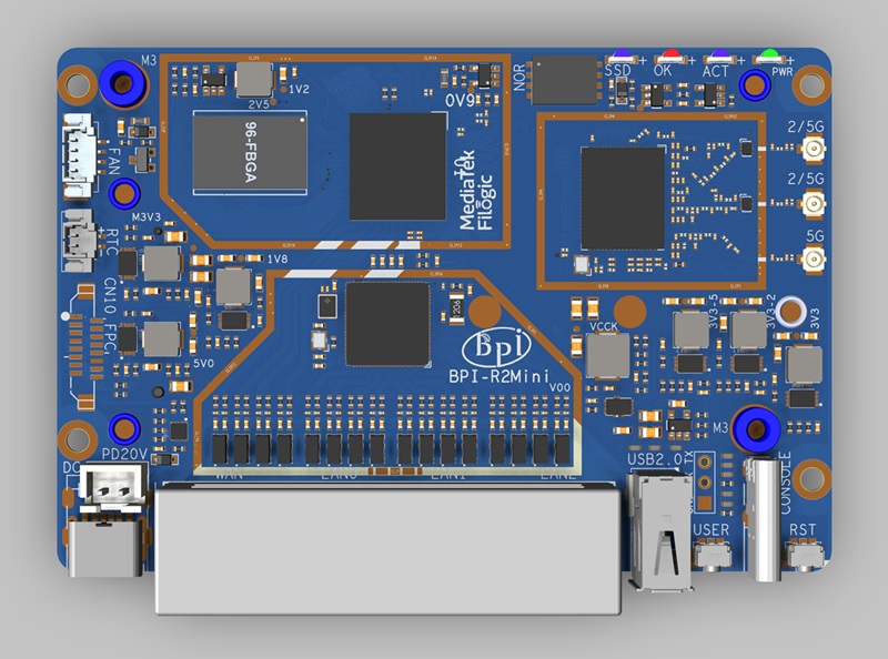

The FPC connector only contains SPI/I2C signals and can be used to connect a small LCD or other SPI peripherals.
I’ll secretly show you the version used by R&D :rofl:.
