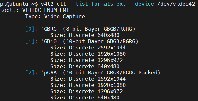

  1. Use v4l2-ctl --list-formats-ext --device /dev/video42 querying device video format. 64c2d9f5fa6c4c99ab089951205c85a1

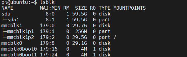

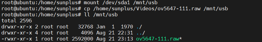

  1. Insert the USB flash drive and mount it, then copy the generated OV5647.RAW file to the USB flash drive. 2af62a38130a3823feed559e8daa05d2

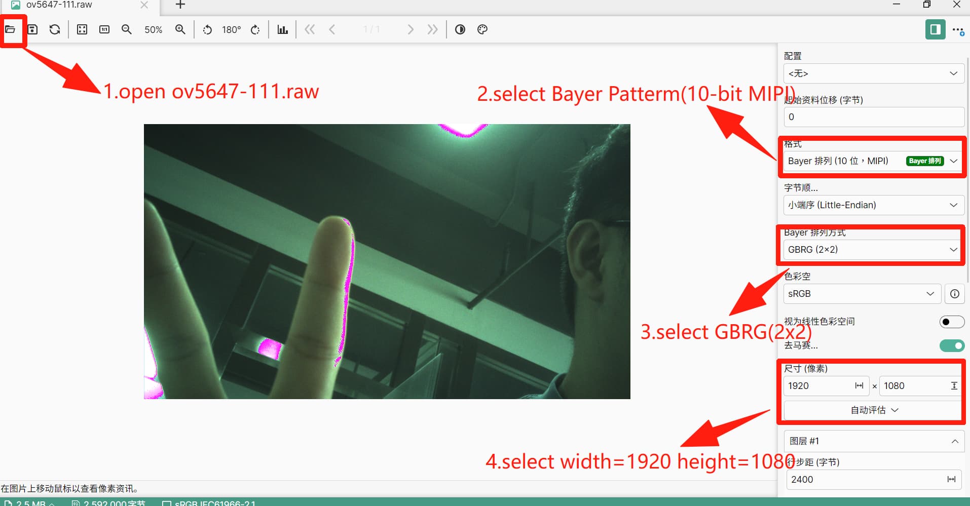

  1. Download raw image viewer from PixelViewer | Carina Studio
