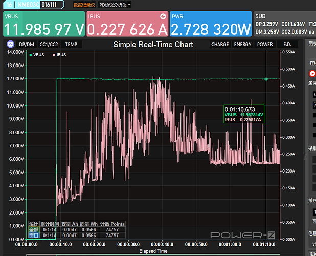

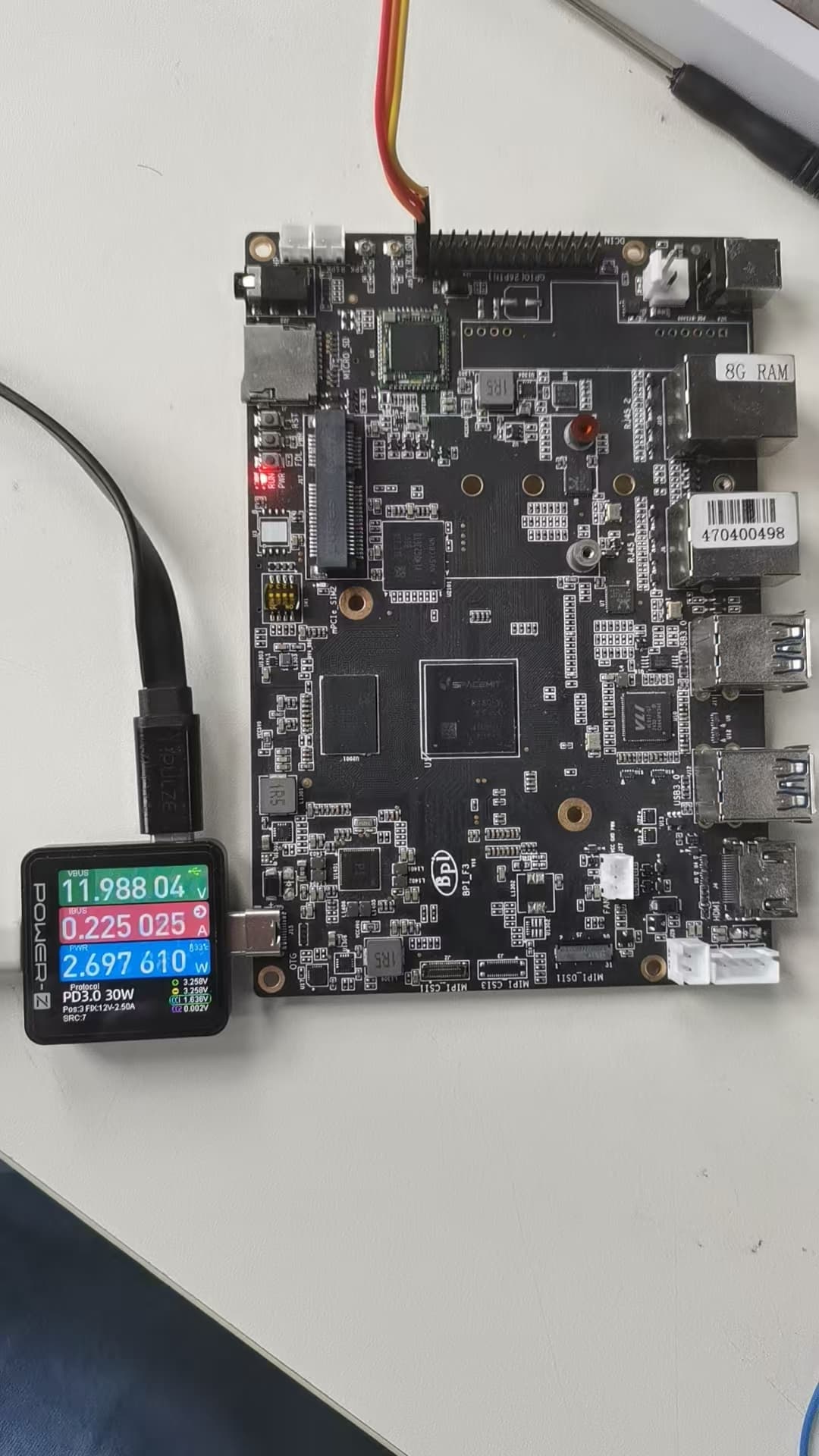

Hello, I’ve used a power meter to test the 8G F3. The F3 was not connected to any devices. As you can see from the image, its idle power is approximately 2.64-4.78W.Hope this helps you.

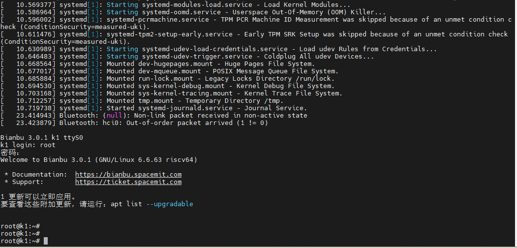

The image used is Bianbu 3.0.1.
