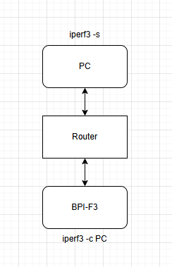

Prepare a BPI-F3 board, a PC, a router and two network cables.
Connect the items as shown in the diagram below:

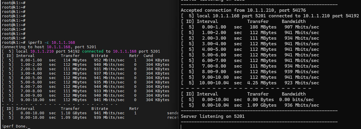

Connect RJ45_2:

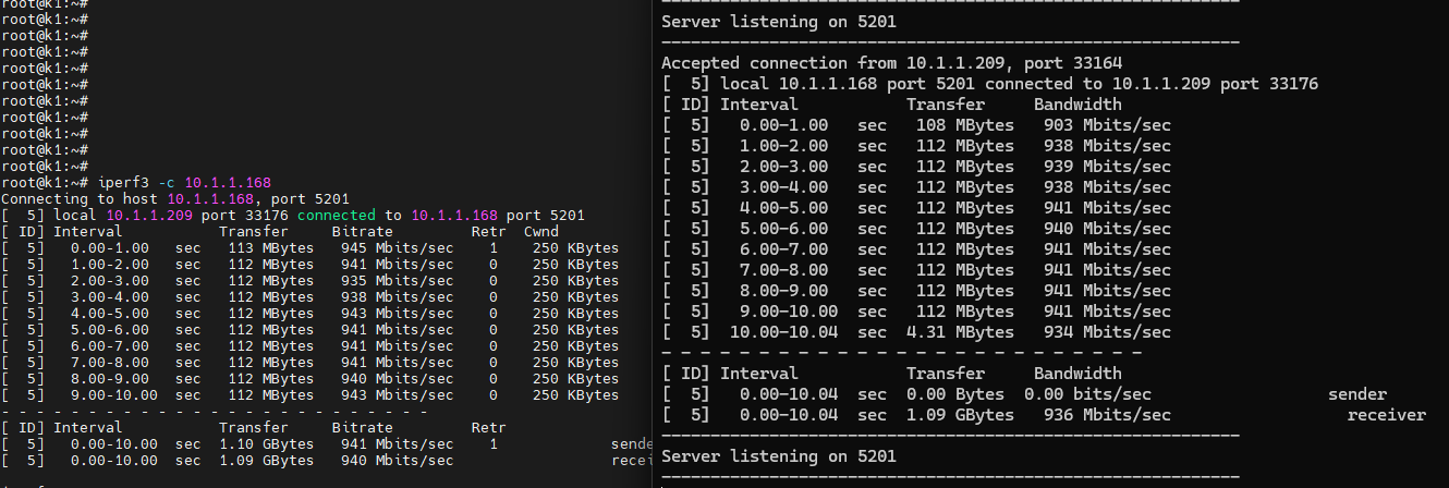

Connect RJ45_1:
The two network ports of BPI-F3 can both achieve a speed of 941 Mbits/sec.
