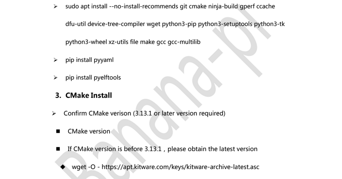

Linux SDK Compile and burn
http://wiki.banana-pi.org/EAI80_Burning_Steps_(Elementary)
