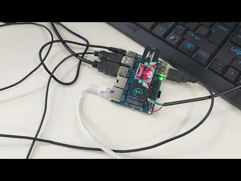

BPI-CM6 M.2 SSD read and write test
Hardware used: CM6 and an NVME brand of fanxiang.
I used an NVME brand to connect to the M2 port of the CM6.Then use the command to query:
