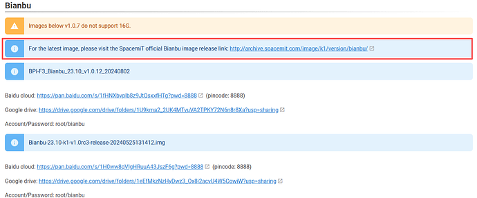

I couldn’t get mine to boot with bianbu-23.10-desktop-k1-v1.0rc1 or bianbu-24.04-desktop-k1-v2.1.1 from Banana Pi BPI-F3 | BananaPi Docs, but bianbu-25.04-desktop-k1-v3.0.1 from bianbu.spacemit.com is working well.
Download the latest image from this link.
