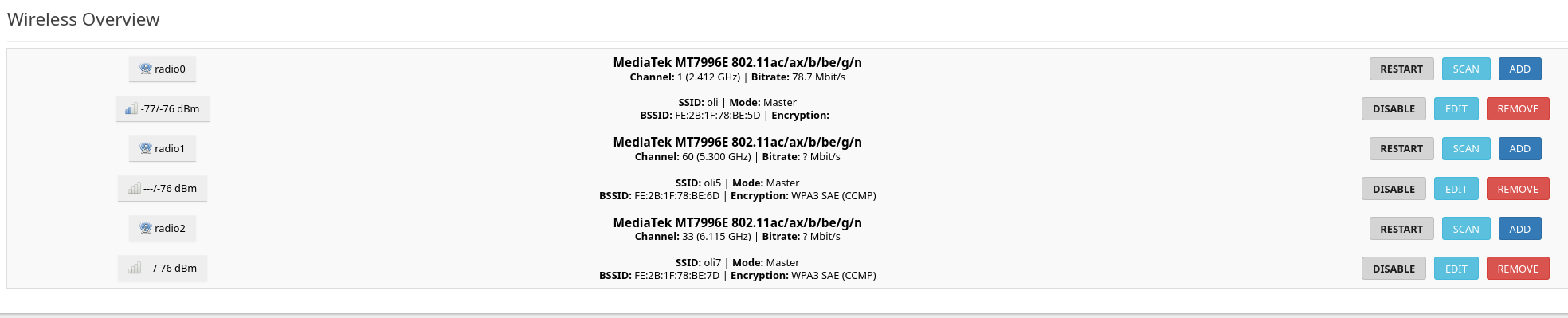

BE1400 terrible range, slow speeds and one of the radios is disabled. This is with only a single device connected
I have seen this discussed in several other topics and on other websites too, but the information is all over the place. Apparently there was a pretty big change just before I purchased my BPI-R4.
I have tried OpenWRT, Ubuntu 24.04 and Debian Bookworm and in all cases the wifi performance is not great, the range is awful and the 6GHz radio is not active.
Im not sure which radio is which when listing the interfaces in Ubuntu, but regardless of OS I always end up with a 2.4GHz network, a 5GHz network and the 6GHz radio disabled.
I have tried changing the country code from US to JP and still nothing. I saw that suggested a couple times.
I have the metal enclosure and I have replaced all the thermal pads on the entire unit, I also only have one device connected wirelessly so it’s not really getting warm.
So I’m not sure what directions to follow, or what to try in order to get the WiFi performing where it should be.

you should probably go with openwrt.org instead of the mtk one. i use master and all works for me:
ignore the noise, this is coz i have the wrong antenna cables, the new one will ship in a few weeks and i am too lazy to install the old ones. only thing i noticed is that it takes some time (2-3 minutes) until all radios are up. and another thing: when restarting one radio, all will restart.

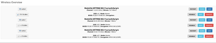

Also would you mind sharing your WiFi settings? I can never seem to get all three radios up at the same time. And all three max out at 7dB when they should be able to go up to 22dB (if I recall). I tried messing with some settings and just made it worse and I don’t see a “reset to default” button or anything.
Stupid question, but do your WiFi cards LEDs light up? Only the 2.4GHz light is on, even when 5GHz is working.

Amazingly, somehow the latest snapshot is actually worse than the previous ones. But I did as you suggested and captured the logs and opened a GitHub issues.
thats really wierd, there is a lot going on… did you see those:
daemon.err hostapd: Pre-RSNA security methods are not allowed in 6 GHz
Sat May 3 06:04:12 2025 daemon.err hostapd: 1 errors found in configuration file '<inline>'
Sat May 3 06:04:12 2025 daemon.err hostapd: Failed to set up interface with data: driver=nl80211 logger_syslog=127
that could at least explain why your 6ghz is not working. do you also have odhcpd installed? i thought the default openwrt image does not use that.
there are really a lot of errors and warnings in your log. this looks also a bit fishy to me:
06:04:01 2025 daemon.err hostapd: Failed to create interface phy0.1-ap0: -23 (Too many open files in system)
can you check how high your max filehandle is?

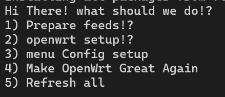

i knew i added some patches manually :stuck_out_tongue:
oli@DESKTOP-RA0V02P:~/openwrt$ ls package/kernel/mt76/patches/
002-use-tx_power-from-default-fw-if-EEPROM-contains-0s.patch
0152-cp-mtk-mt76-mt7996-config-rxfilter-to-drop-other-unicas.patch
wifi: mt76: mt7996: Use tx_power from default fw if EEPROM contains 0s · danpawlik/mt76@da5a863 · GitHub i think this one should fix the radio problem with power. dont know if those patches are in the latest snapshot, because those patches are really fresh.
