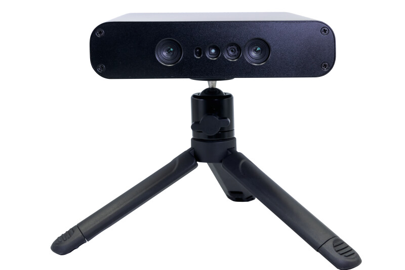

This is a 3D camera kit developed based on BPI-M7 (RK3588).
Place the entire machine in a constant temperature box, wait for a certain time within the specified temperature, then power on and start the device, and turn on the use of color screen, depth, infrared, and data streaming functions.

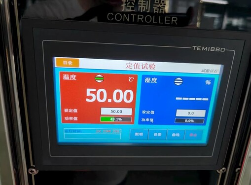

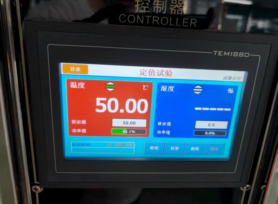

High temperature

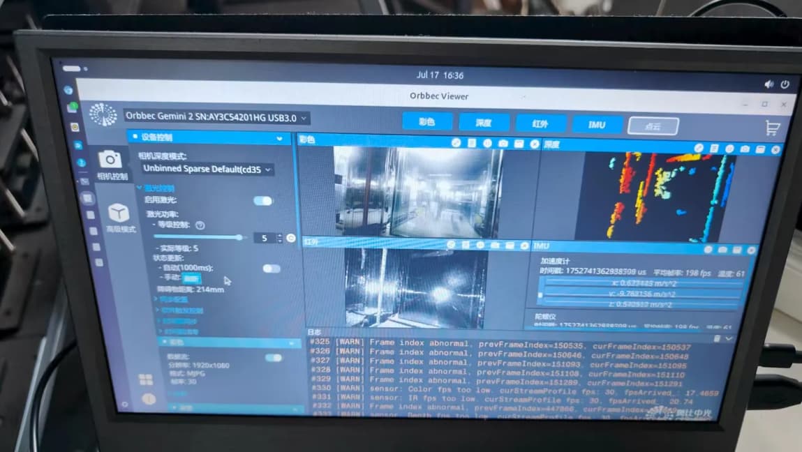

At 50°C, the board starts normally and the screen is normal.

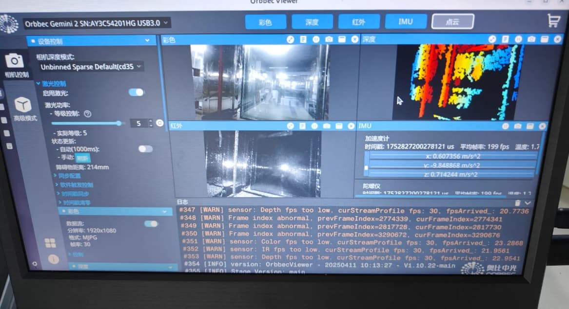

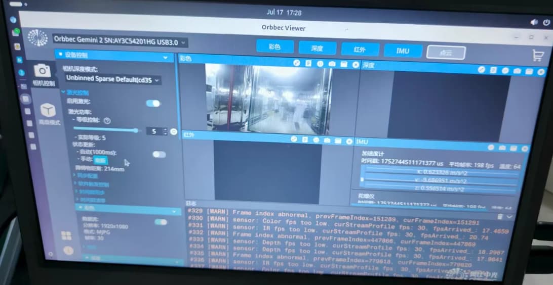

When the temperature rises to 55°C, the board starts normally. But the depth and infrared image are lost.

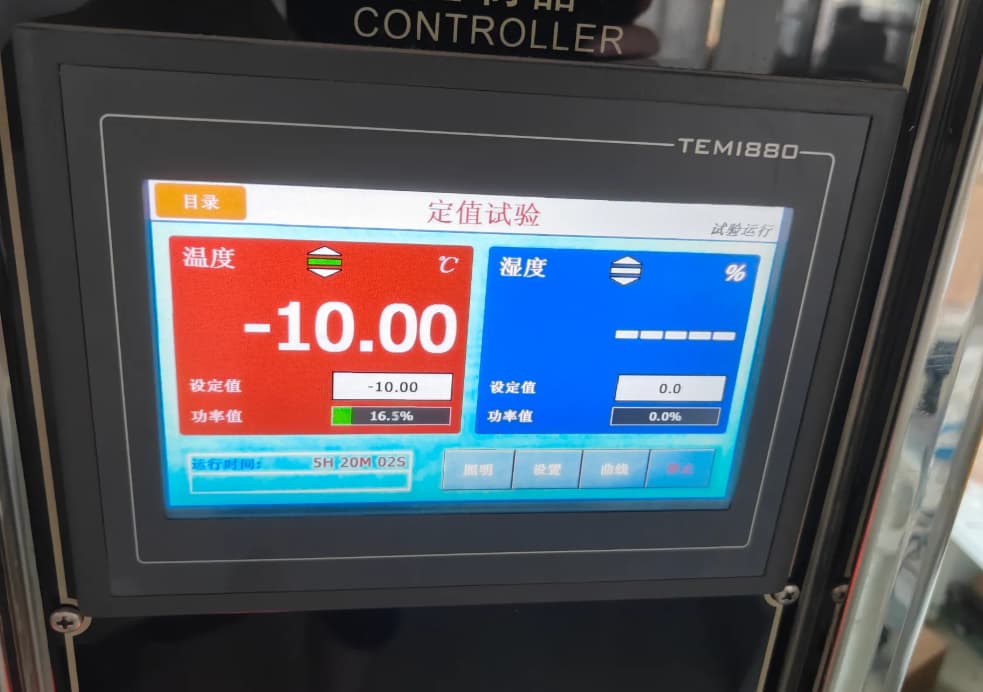

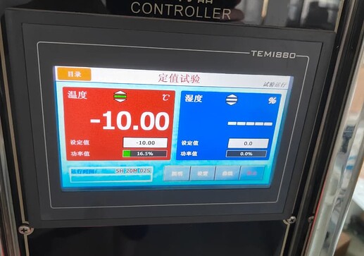

Low temperature
When the temperature is -10℃, the board starts normally and the screen is normal.
