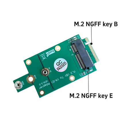

Hi,
if you want to use dual band WiFi with the BPI-RV2 you can use a second WiFi module in the B key slot. It works using this adapter:
Tested with AC and N Atheros WiFi, 5 antennas

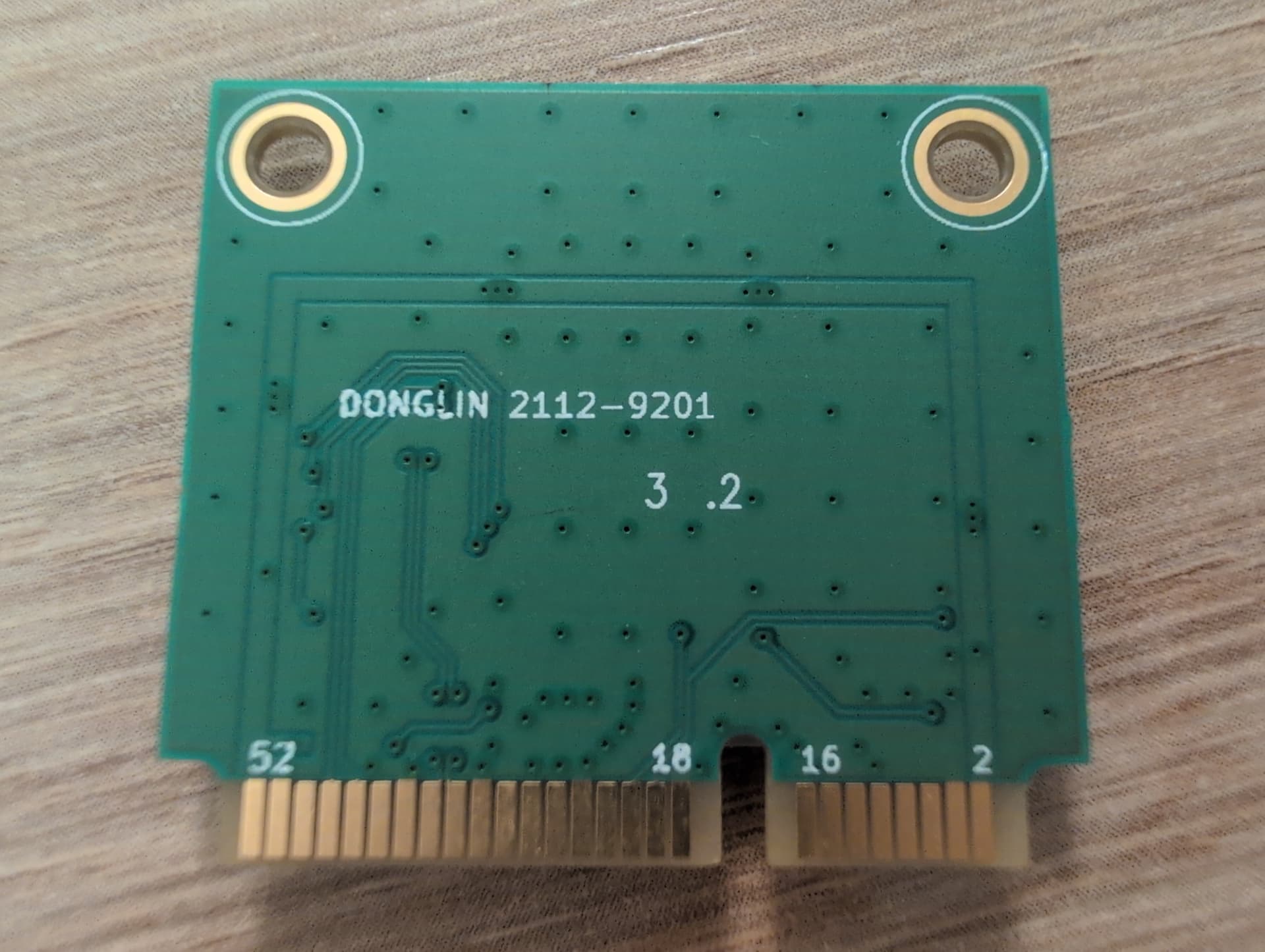

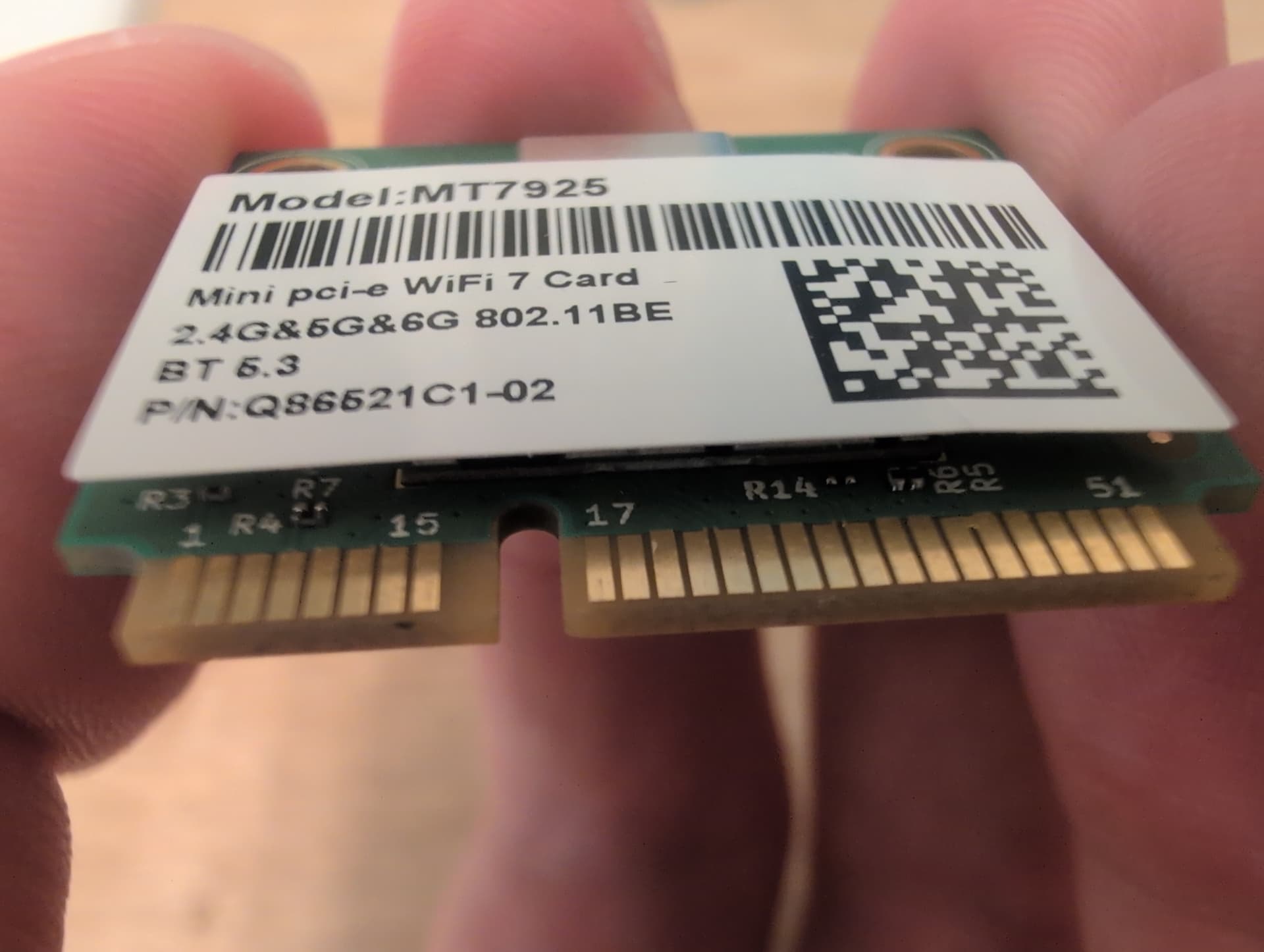

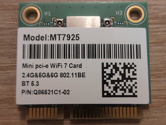

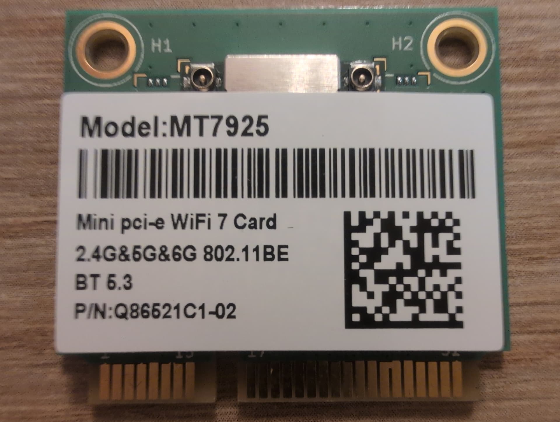

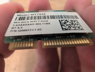

I want to share my experience with Wi-Fi chips on the Banana Pi BPI-RV2, in case it is useful to someone else. I used OpenWRT 25.12.5 with Linux kernel 6.12.94.
Did NOT work: MediaTek MT7925, via Mini PCIe. The device could be seen in lsusb, but did not show up in lspci. There was no error in dmesg. The log was the same as for the other (currently empty) M.2 slot, meaning that I did not have any useful logs to debug.
Worked: MediaTek MT7612E, via Mini PCIe.
The PCIe lanes for the Mini PCIe and M.2 Key B devices should be fine; the issue is likely due to the drivers not being added in the software.
@hyf Thanks for your reply. For the MediaTek MT7925, I did install the kernel all modules called kmod-mt7925* and their dependencies from here. I checked multiple times and to my knowledge I don’t think I forgot anything.
In case anyone is interested, I will post some logs from the boot with a MediaTek MT7925. The reason for posting them here instead of opening a new topic is because I’m genuinely curious to find out why some Wi-Fi cards don’t work, or whether they have different root causes. I am ready to perform further tests if anyone has any ideas.
The output of dmesg does not show any error, but just “Phy link never came up” (both for the Mini PCIe that has the MediaTek MT7925, and for the empty M.2 slot). We can also see that the mt7925u driver is being loaded:

The output of lspci does not show the MediaTek MT7925 (note: the error below is unrelated, and not displayed when executing only lspci without further parameters):
root@OpenWrt:~# lspci -nnk
0000:00:00.0 PCI bridge [0604]: Device [1a0a:abcd] (rev 01)
        Kernel driver in use: pcieport
lspci: Unable to load libkmod resources: error -2
0001:00:00.0 PCI bridge [0604]: Device [1a0a:abcd] (rev 01)
The output of lsusb shows that the MediaTek MT7925 is detected, so Bluetooth would work (but that’s not what I need):

Check the M.2 Key E pinout on your module because if the PCIe TX/RX lines aren’t connected on the card side, the Siflower SF21H8898 host controller will fail the PHY link training step every time
Unfortunately, I don’t have the wiring of the MediaTek MT7925. The package did not include any manual or anything else.
I purchased the incompatible MediaTek MT7925 from here: Zhdbchyuu PCIE Wireless WiFi 7 Netzwerkkarte MT7925 5400Mbps Bluetooth 5.3 Tri-Band 2.4G/5G/6G WiFi Adapter 8DB Antenne: Amazon.de: Computer & Zubehör
The chip above has numbers above certain pins, but these are probably useless without actual schematics describing what the pins do. Here are the photos:
