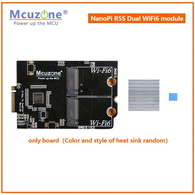

Ok, now I was overdoing it:
root@OpenWrt:/# lspci
0000:00:00.0 PCI bridge: MEDIATEK Corp. Device 7988 (rev 01)
0000:01:00.0 Network controller: MEDIATEK Corp. Device 7990
0001:00:00.0 PCI bridge: MEDIATEK Corp. Device 7988 (rev 01)
0001:01:00.0 Network controller: MEDIATEK Corp. Device 7991
0002:00:00.0 PCI bridge: MEDIATEK Corp. Device 7988 (rev 01)
0002:01:00.0 PCI bridge: ASMedia Technology Inc. ASM1182e 2-Port PCIe x1 Gen2 Packet Switch
0002:02:03.0 PCI bridge: ASMedia Technology Inc. ASM1182e 2-Port PCIe x1 Gen2 Packet Switch
0002:02:07.0 PCI bridge: ASMedia Technology Inc. ASM1182e 2-Port PCIe x1 Gen2 Packet Switch
0002:03:00.0 Network controller: Intel Corporation Wi-Fi 6E(802.11ax) AX210/AX1675* 2x2 [Typhoon Peak] (rev 1a)
0002:04:00.0 Network controller: MEDIATEK Corp. MT7921K (RZ608) Wi-Fi 6E 80MHz
0003:00:00.0 PCI bridge: MEDIATEK Corp. Device 7988 (rev 01)
0003:01:00.0 Wireless controller [0d40]: MEDIATEK Corp. Device 4d75 (rev 01)
Seems to work fine
Just a bit of space problem with the huge BE19000 module installed as well…
