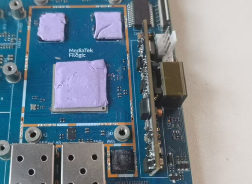

I wonder if it would be possible to add a POE module to the 8x version? The layout allows to add such, but how is it with the ethernet connection? (and yes, of course SFP+ and POE does not work at the same time/line/ā€˜cable’.
If this is the wrong forum please redirect me to the right one.
Best regards, kai
Afaik this can only be done with 4e variant as this uses internal 2.5g phy from mt7988 soc for wan instead of 10g phy+SFP+ slot combo.
I soldered a PoE module onto the R4Pro myself, and it can now power the R4Pro normally.
Seems like this is the 8x variant…it does also work through the aeonsemi phy?
