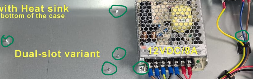

A 12 VDC power supply is available from various electronics stores. Threaded bolts (circled in green) are provided in the housing for attaching power supplies and fans. I designed and implemented the cable assembly, including the necessary crimp connections, myself. The two 230 VAC~ power plug connections are located on the left and right rear panels.

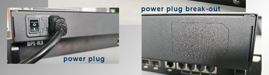

Good to know thank you for the quick reply! I live in the US so I hope they’ll be willing to ship. Do you use the Wifi card with this? How is the signal? (I know the wifi is notoriously bad) How are the heat temps running two in one enclosure? Also do you have a picture of what the back looks like for fitting a 12VDC power supply? Thank you for your time!! I’m impressed by your crimps. I’ve recently started researching and getting into crimping/ferrules for another power related project working with terminals.
I’m glad you like it. I haven’t used WiFi in this housing yet. To do so, holes would have to be drilled for the SMA connections. Heat generation is not a problem; with active/passive cooling, I don’t exceed over 40°C on the CPU.
Picture of what the back looks like for power supply:
