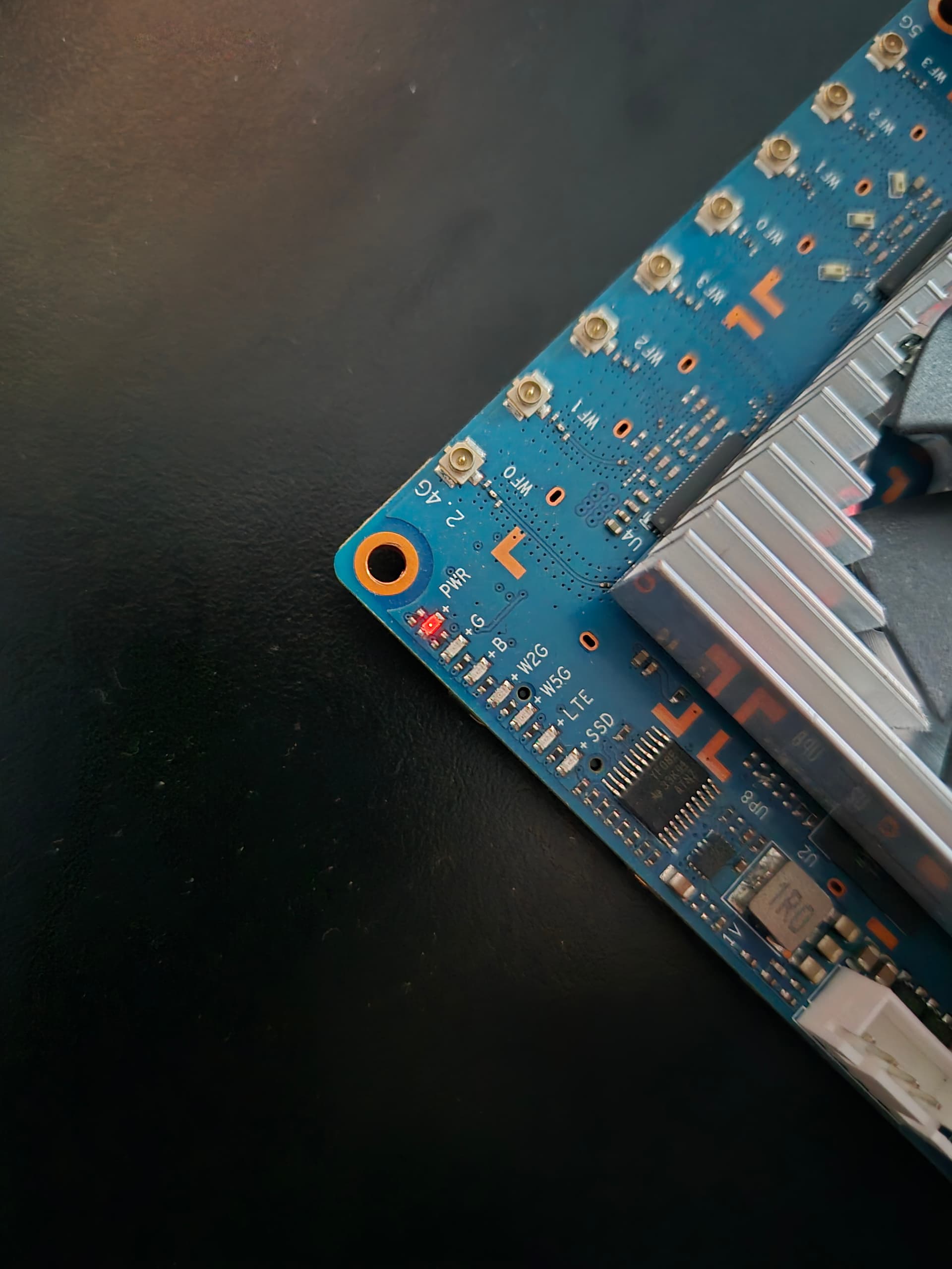

Good morning. This morning, for unknown reasons, the router stopped working (I should mention that it had been working properly for almost 1.5 years). The router boots from SD cards. After the failure, the red LED blinks very gently (almost invisible) at short intervals. After unplugging and reconnecting the power, the red and blue LEDs blink rapidly, and then, as I mentioned, only the red LED blinks gently. The RJ-45 port is lit continuously. Could you please tell me if this means the router is dead?

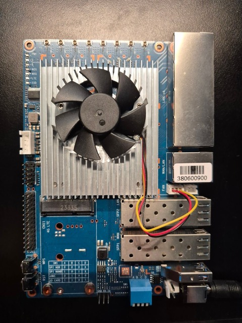

Not sure if hijacking this thread is a good idea, but mine seems dead too. No LED (just a little glimpse for the Power). The fan does not spin. I’ve tried another power supply to rule out this one but still no signs of life. Any ideas?
