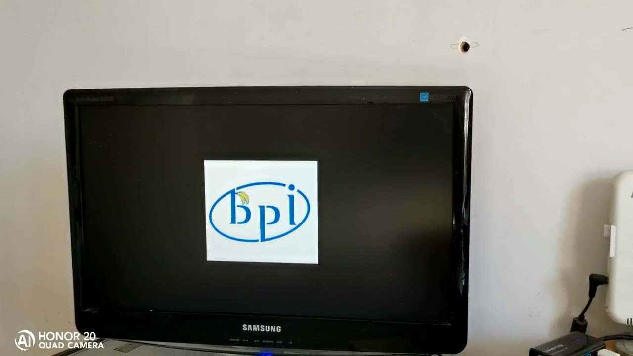

Where did you get these bootup logs from ?
first post from this thread
below the video
Ah ok. I thought you booted on some device.
