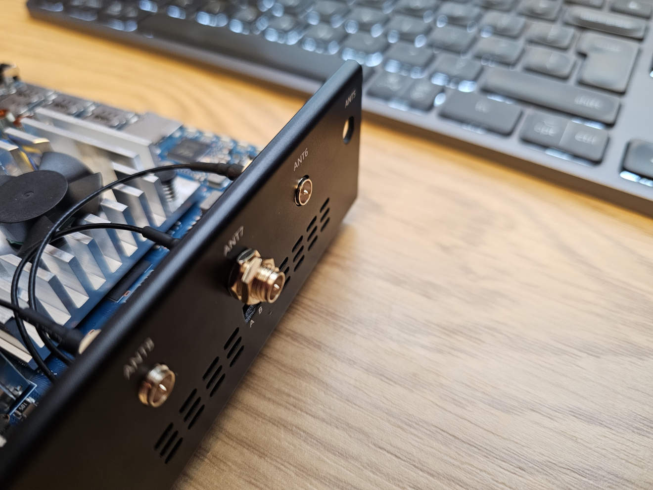

I have a problem with pushing antenna’s connectors via dedicated holes. They are a bit too tiny. Any suggestions how to properly install that?
Have you removed all nut/rings before inserting?
You have seen that hole is not a comple circle and flat on one side? Antenna connector has also a flat side…
Clever, haven’t noticed that. I’ll check that in the evening.
