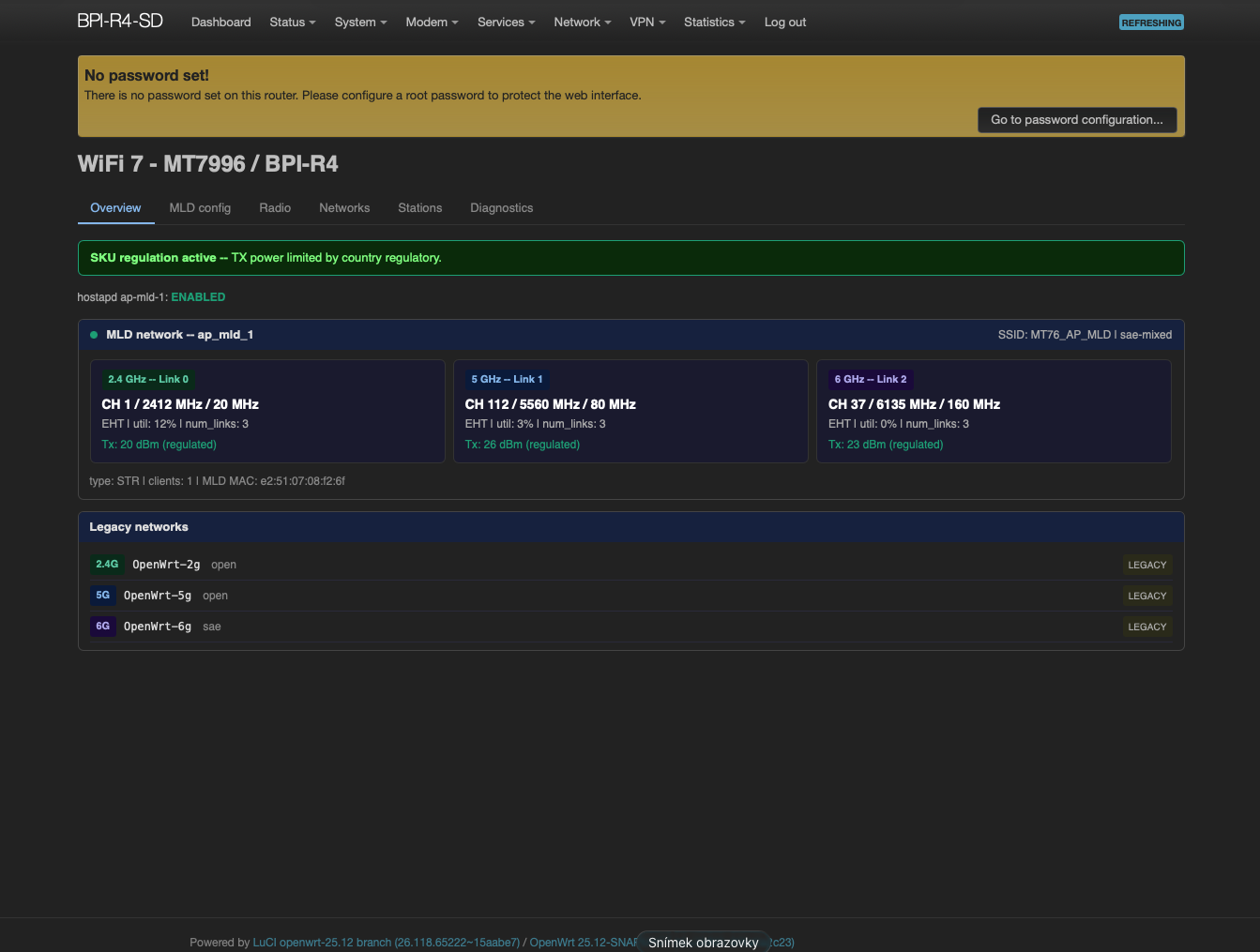

  • Overview — Live MLD link cards showing channel, bandwidth, TX power, channel utilization per link. SKU regulation status banner.

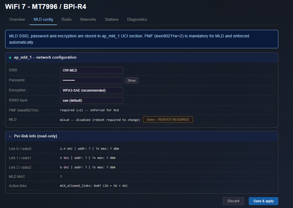

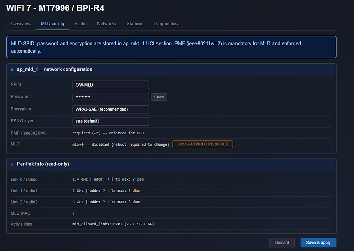

  • MLD config — Edit MLD SSID/password/encryption. MLO enable/disable with reboot warning. Per-link addresses and TX max.

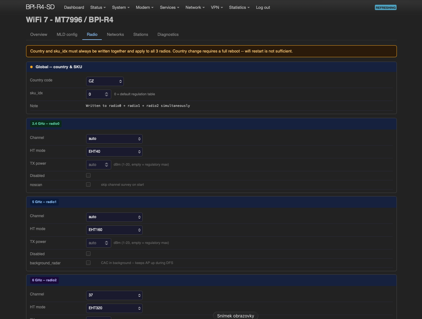

  • Radio — Channel, HT mode, vif_txpower per radio. Country + sku_idx always written together (as they should be). DFS channel labels, lpi_enable, background_radar.

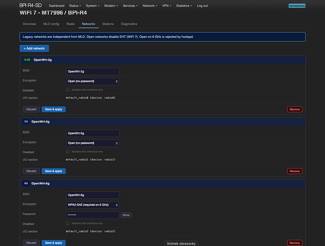

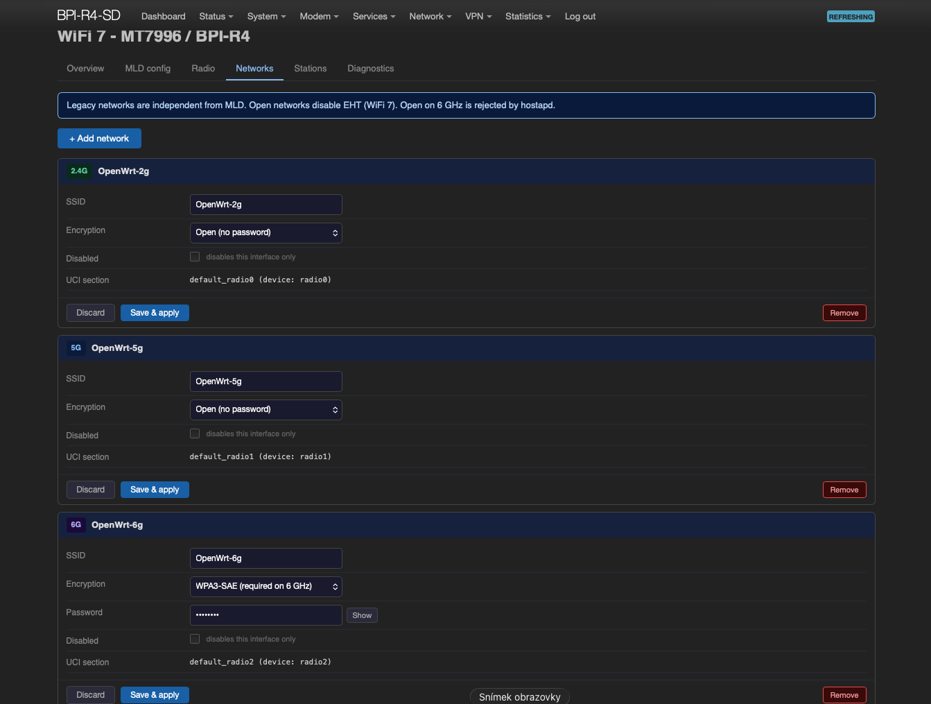

  • Networks — Add/Remove legacy networks with smart defaults per band (6G enforces SAE automatically). Advanced settings expandable.

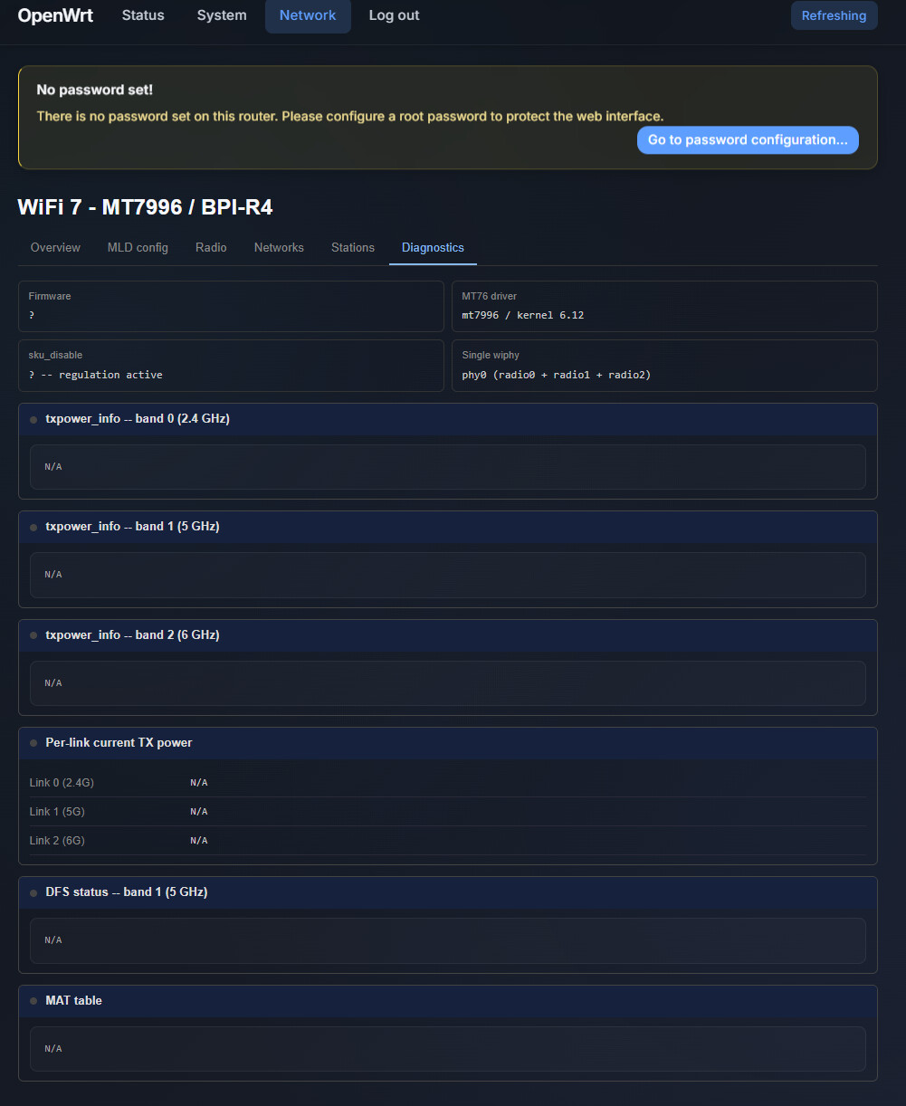

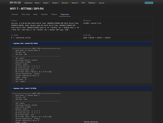

  • Diagnostics — Firmware version, sku_disable status, txpower_info per band, per-link current TX power, DFS status, MAT table.

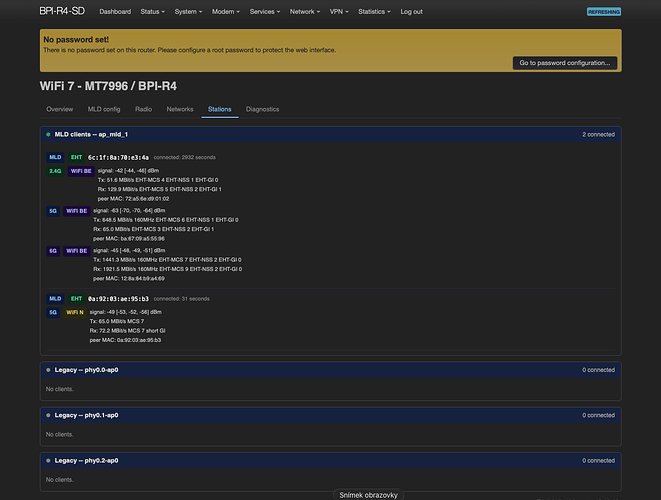

whats the difference to network->wireless in luci? screenshots would be nice

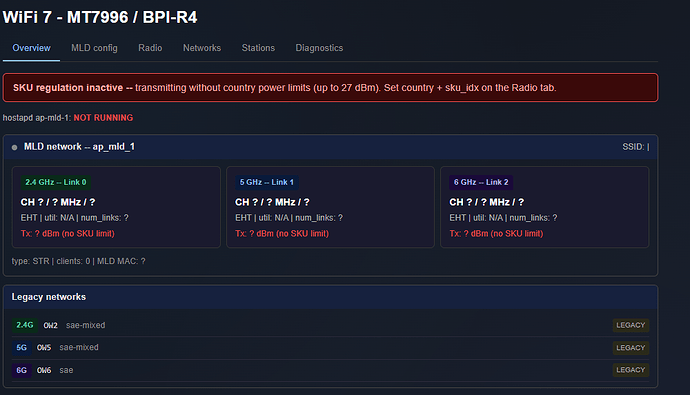

  • BPI-R4 Pro 8X(MT7988A / Filogic 880)
  • MT7996 tri-band (2.4G + 5G + 6G)
  • OpenWrt SNAPSHOT r34136+2-8ef7b4ee4b
  • LuCI Master 26.115.45124~15b8288

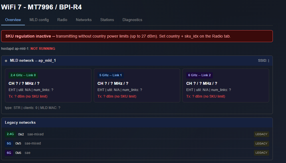

Can’t enable MLO. Setup from MLD config page - not works = resets to blank. Reboot - same effect Also 6ghz interface configured 6ghz be 320mhz - drop connected clients to AX 160mhz ** probs not related for this 5ghz also too
Diagnostics tab = blank
Please first reboot the router (full power cycle recommended), then run these commands and paste the output:
bash
uci show wireless | grep mlo
hostapd_cli -i ap-mld-1 stat | head -10
This will tell us whether the MLO setting survived the reboot and whether hostapd is running correctly.
:warning: Important: This module requires OpenWrt with MTK SDK (e.g. woziwrt/bpi-r4-deploy build). It is specifically designed for the MTK SDK WiFi stack — the interface naming, MLD configuration and hostapd parameters differ significantly from mainline OpenWrt and it will not work correctly without MTK SDK.
Please confirm you are running a MTK SDK based build before troubleshooting further.
Pin it in first post, I’m using mainline, so that’s the problem. Thx
Will do, thanks for confirming!

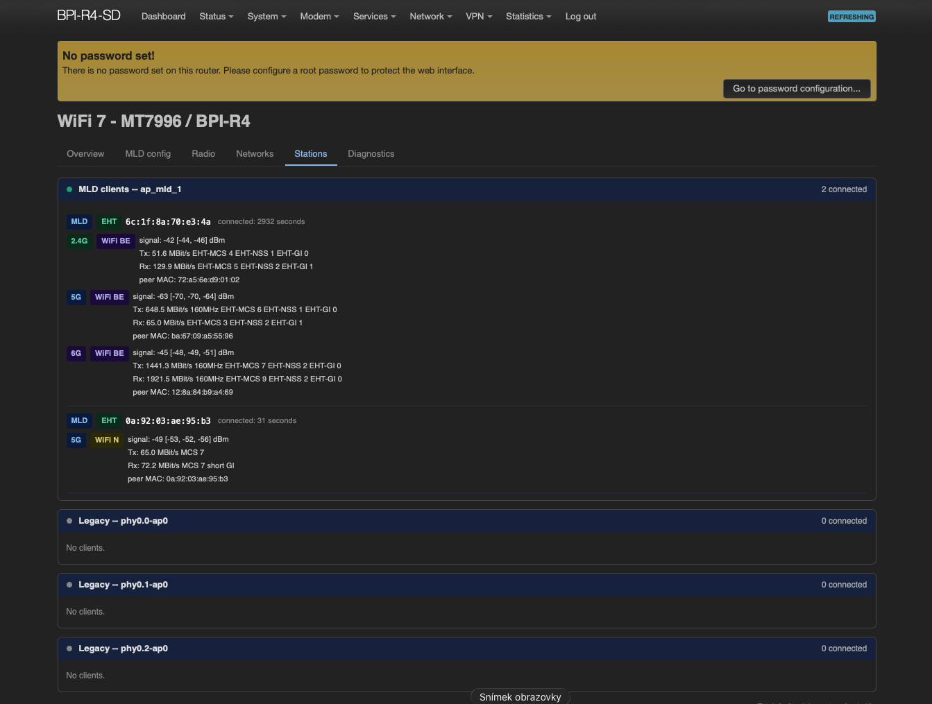

Overview tab
  • Live MLD link cards with UP/DOWN status (real-time radio state)
  • SKU regulation 3-state banner — inactive (red) / partially configured (orange) / active (green)
  • ACS selected channel displayed live when channel=auto
  • Multiple MLD networks displayed dynamically — all configured MLD SSIDs with full link cards

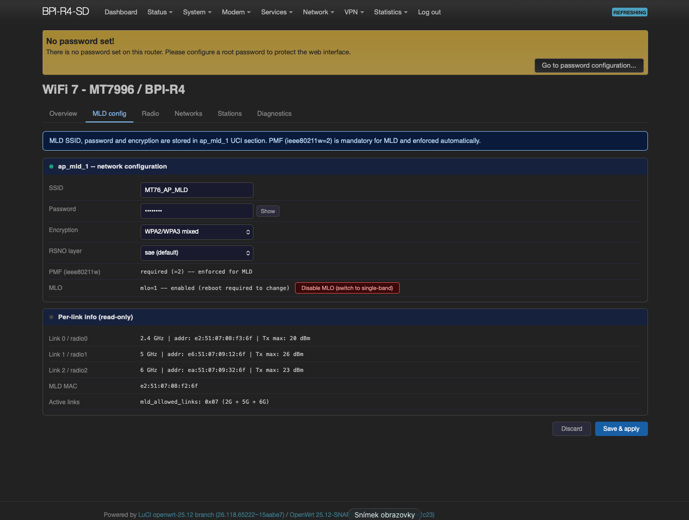

MLD config tab
  • Add MLD network wizard — create additional MLD networks (mlo0, mlo1…) with SSID, password, encryption, radio selection
  • Per-link info hidden automatically when MLO is disabled
  • EMLSR status display
  • Country change reboot warning
Radio tab
  • he_twt_responder (TWT) per radio — IoT power saving toggle
  • legacy_rates — 2.4G legacy rate support toggle
  • Advanced shared section (single wiphy): sr_enable (Spatial Reuse / BSS Coloring), etxbfen (TX beamforming)
  • noscan warning — explains slow restart risk
  • Radio disable confirm dialog — warns about MLO link ID renumbering
  • DFS enhanced — distinguishes standard DFS (CAC 60s) from weather radar channels (CAC 10 min ETSI)
Networks tab
  • Network bridge assignment — lan / wan / guest / iot / custom per interface
  • Hidden SSID, Client isolation, Max clients (maxassoc), WMM toggles
  • OWE Transition mode — Open + Enhanced Open simultaneously
  • Remove network warning — warns if MLD uses the same radio
Stations tab
  • Signal quality color coding — green ≥ -65 dBm / orange ≥ -75 dBm / red < -75 dBm
  • Dynamic display of all MLD networks and legacy interfaces — no hardcoded interface names
  • Real station data for all configured networks including additional MLD networks

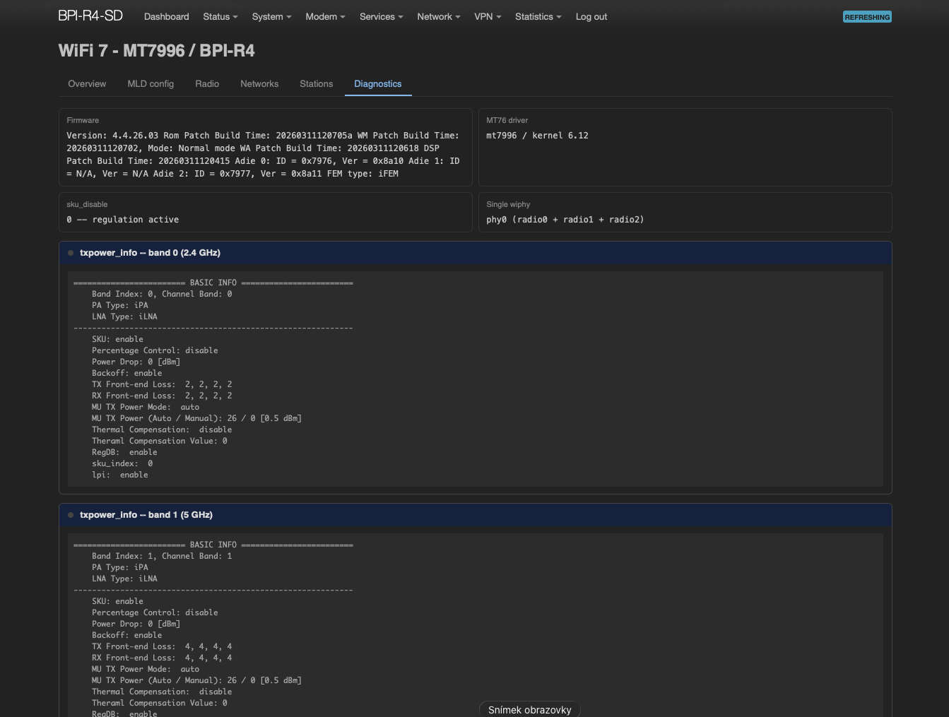

Diagnostics tab
  • Kernel version dynamic from /proc/version (was hardcoded 6.12)
  • Thermal monitoring — named zones
  • Collapsible txpower_info sections — state persists across auto-refresh
  • mt76_links_info — MLO internal topology (master link id, valid links bitmap, per-link bss_idx/wcid/channel/BW)
  • Per-link TX power in dBm
  • Log collection button — downloads dmesg WiFi + logread as .txt
Confirmed hardware
Device Chip Status
BPI-R4 MT7988A + MT7996 :white_check_mark: Primary (4GB + 8GB)
W1700K MT7996 :white_check_mark: Confirmed working
Development continues — feedback and testing welcome.
