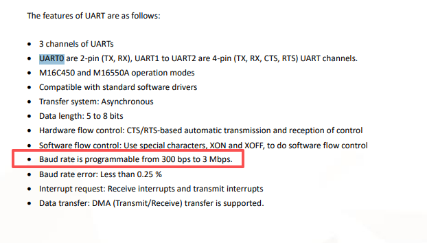

I found information about the MT7988 online. It states that the Baud rate is programmable from 300 bps to 3 Mbps.

Note that there are two additional UART ports on MT7988A. Personally, never looked at how well they’re supported.
