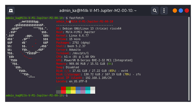

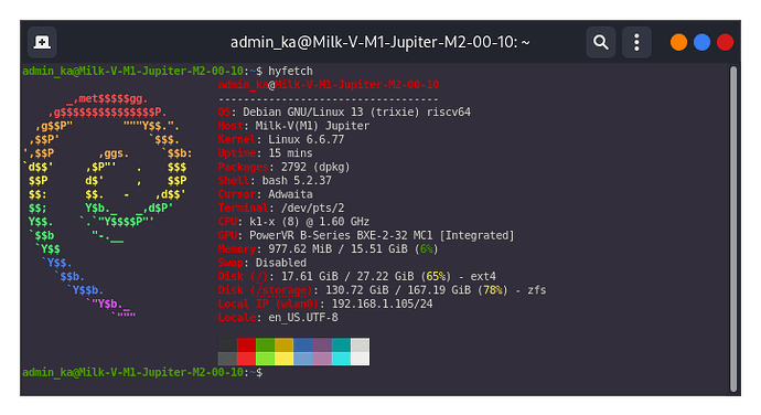

First, I checked whether the kernel was loading the GPU driver at all: $ sudo dmesg | grep ‘pvr’ , and it turned out that for some reason it wasn’t loading. So… I compiled a kernel patched to version 6.6.77 with a check for loading the GPU driver. Now the driver loaded. And now even fastfetch and hyfetch have a corresponding line

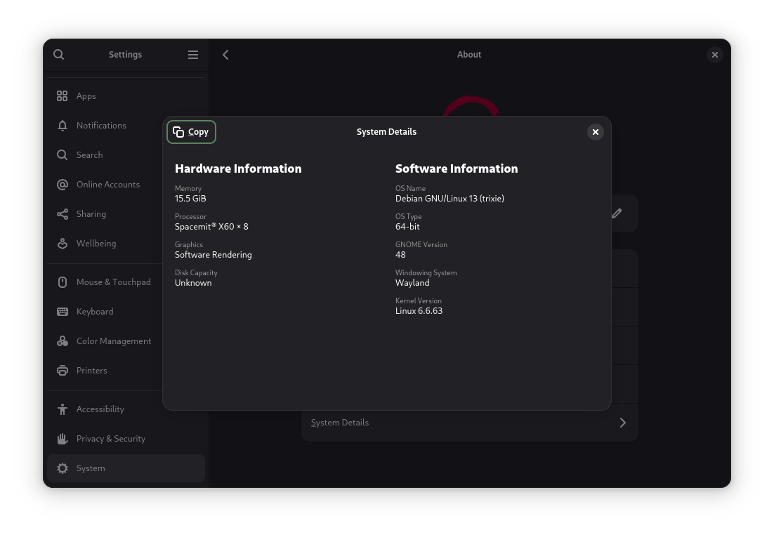

But if you check in the gnome desktop settings, it turns out that
is still running.

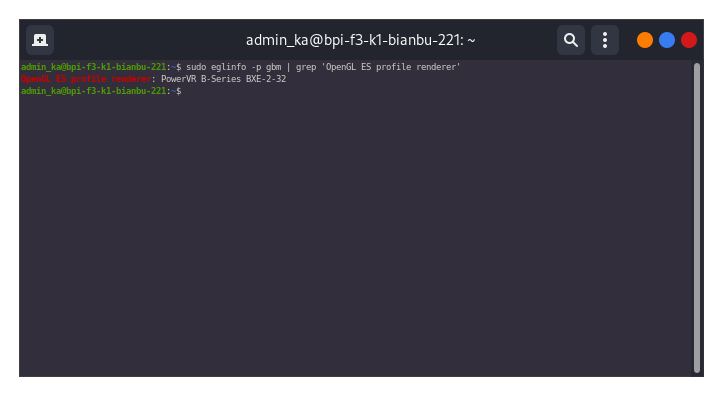

I can’t get hardware rendering to work yet. It works in
But
is Debian 13.
