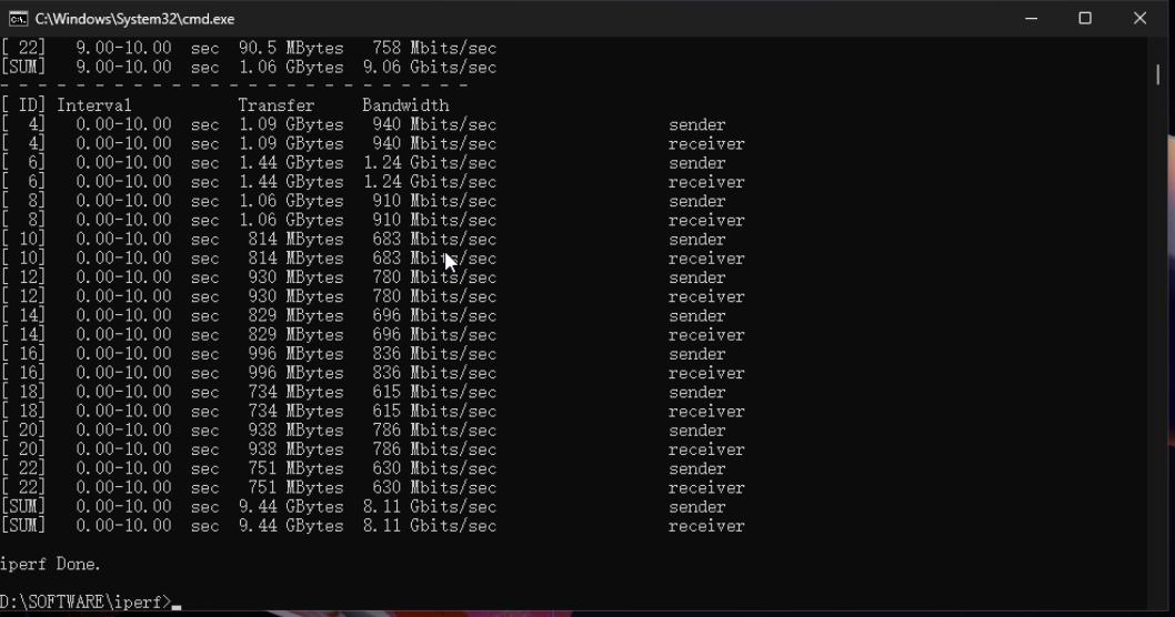

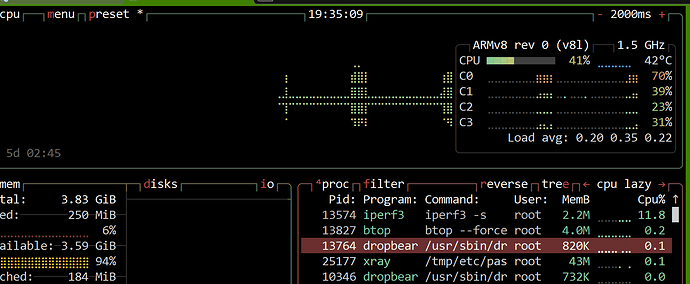

SFP stick
i would first try to rule out the asus and test with another device, if you have any. When i do a speedtest with speedtest.net i get about 7-8gbit down and 5-6gbit up, because the other servers do not provide so much speed. i use openwrt master. did u test r4<->laptop/workstation? is the cable “ok”? i also had a cat6 slim cable and had problems at about 1.5gb and replaced it, now i have full speed.
Yeah, I just ordered a new cable, want to rule out it’s the culprit, will report back after testing )) Thanks

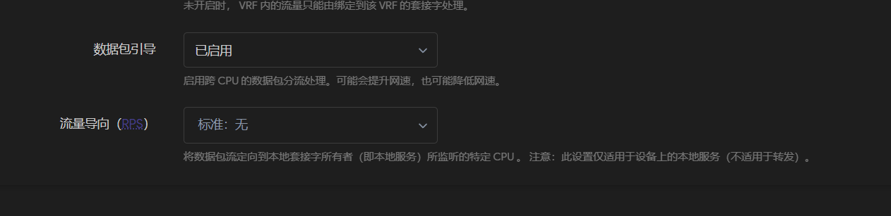

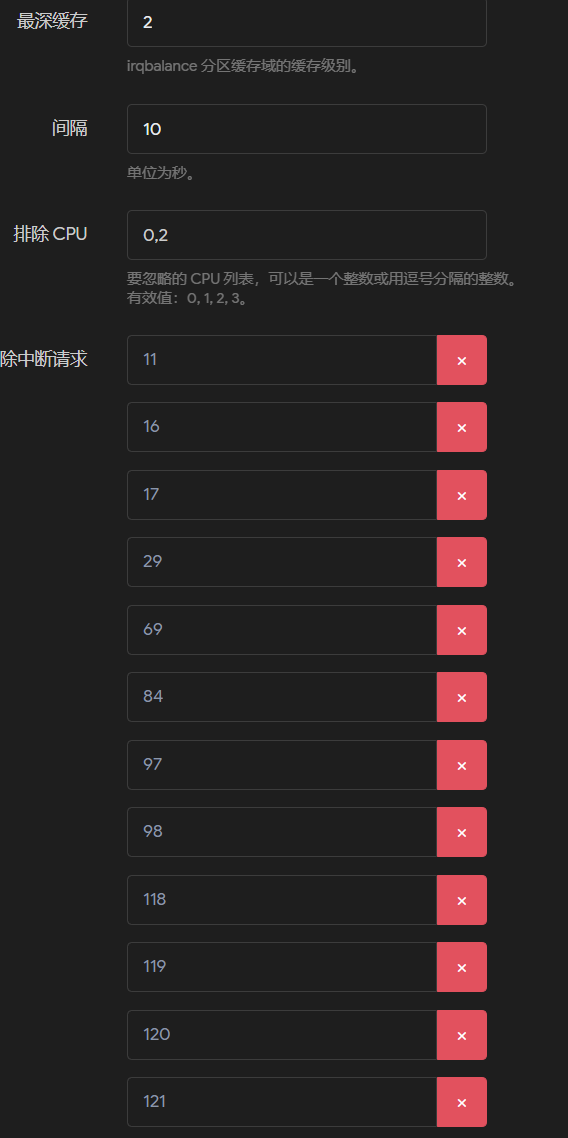

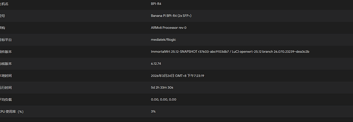

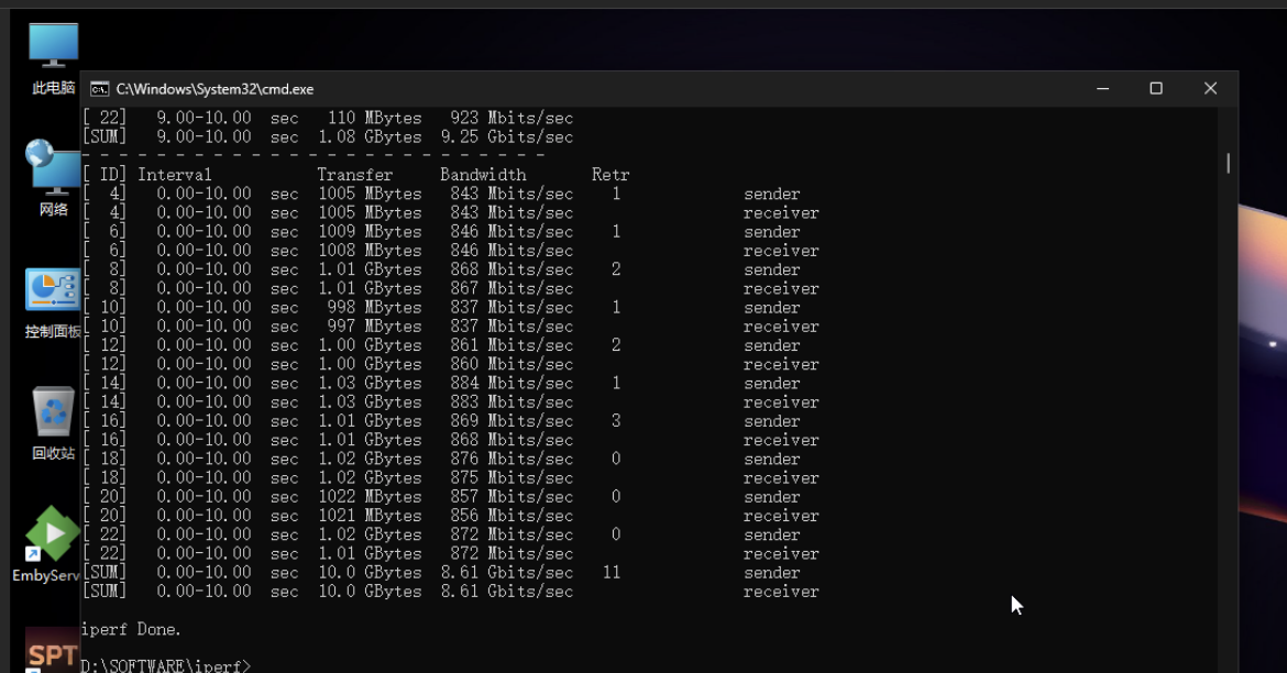

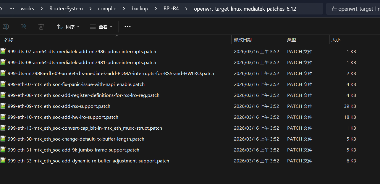

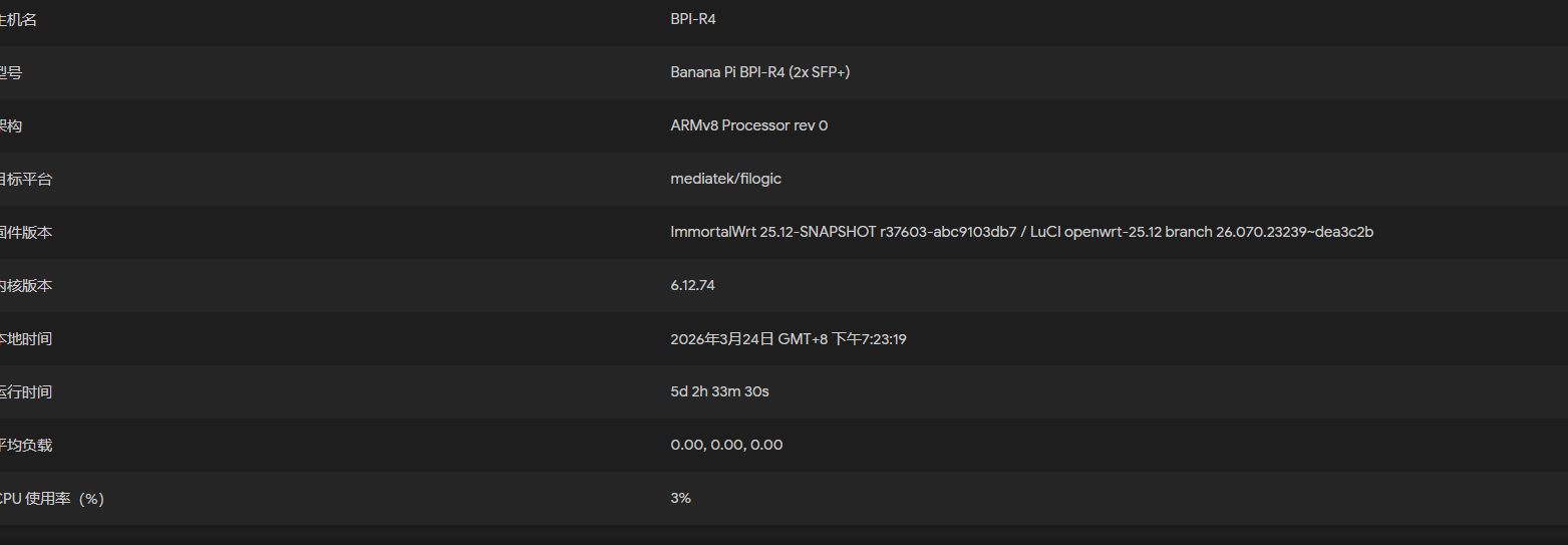

with kernel 6.12 patchs for openwrt 25.12
add luci-app-irqbalance exclude cpu0 and cpu2
interface - > Packet Steering - > Enabled
test
