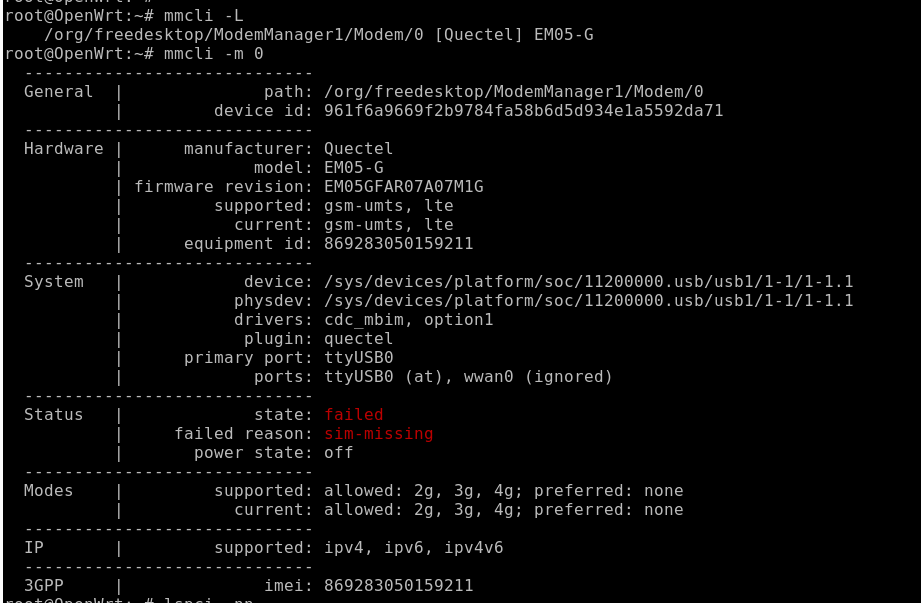

Hi everyone, please be patient, it is my first post on this forum and I have little experience with Banana Pi. I’m currently using a BPI BR-4 with a Quectel EM05-G the modem is properly being detected by the Banana Pi, but not the SIMM card. From the mmcli I get failed sim-missing power state off.
Using the command mmcli -m 0 I get:
The state of the SIMM indicate failed sim-missing and from the interface I get SIM_ILLEGAL_STATE
Anyone know how to set it up properly so my simm will be detected and how do I send AT command to the SIMM from OpenWRT.

I have exactly the same modem installed and it took me a while to figure out how to set it up. The most likely issue is that your modem tries to use eSIM by default, which is not present. Try using the mmcli -m 1 --set-primary-sim-slot=0 command to switch to the physical SIM. I’m not sure this is the one I used to get my modem working, but it pops up on search.

Thank You very much for your answer, it worked, I now can see my SIM
