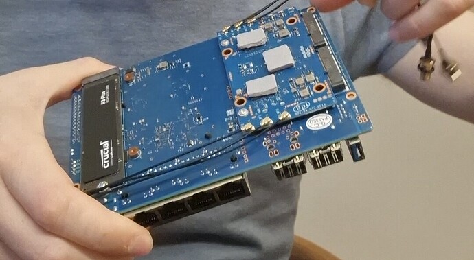

- Got this bpi-r4 kit: https://a.aliexpress.com/_EvWfGgH
- Following 24Wm/k heatpads: https://a.aliexpress.com/_EvoULad
- A Baseus GaN3 Pro 100W USB-C power adapter.
- SMA connector rubber/screws/washers: https://www.aliexpress.com/item/1005006149058995.html
- Crucial P3 Plus 1TB NVMe SSD.
Thank you for sharing, I have exactly the same kit. Do you know which version of the Wifi card do you have? mine is v1.0
Same BPI-R4-NIC-BE14 revision here: v1.0. Was unsure at first, but luckily filmed my assembly of the bpi-r4, so itās definitely v1.0.

- Attaching pics of the overall setup, nothing out of the ordinary that I can see.
