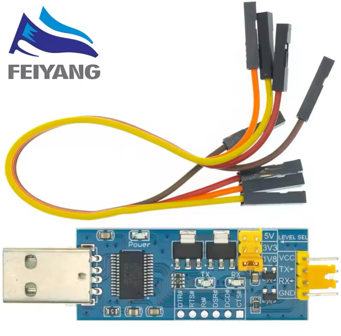

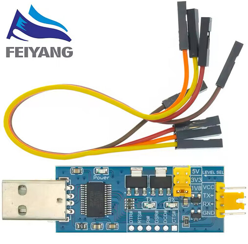

Then just use this one
https://a.aliexpress.com/_EQTp3bc
Thank-you. It looks easier.
It has got 4 cables, and I think 7 connectors on the PCB.
Does it come with instructions on which cables attach to which pins?
you have a 3pin-header on board…with pindescription RX,TX,GND, same on the adapter…you have only swap rx and tx so that sender is on receiver.
make sure your adapter has 3v3 selected before connecting to bpi board
use putty or minicom (or any other you are familar with) with settings 115200 baud 8N1 flowcontrol off on the right serial device
