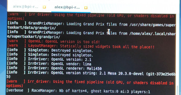

Btw: some new lima “fun” ;):
Not very playable performance, but at least it runs, opposite to earlier versions.
