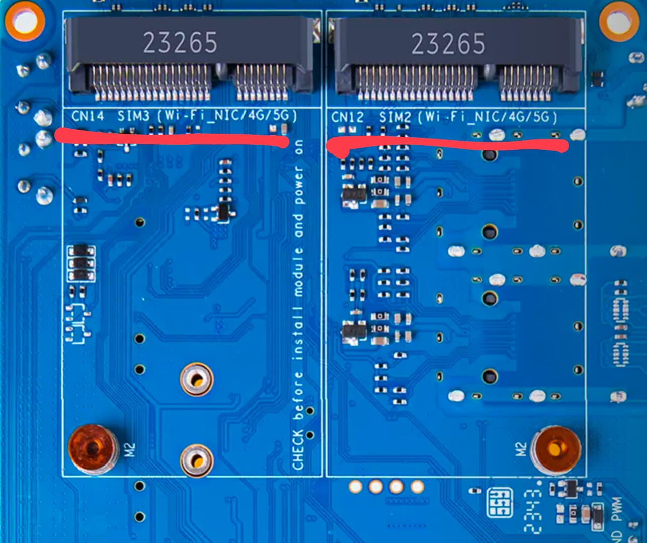

Hmm i am using the Quectel RM520N-GL over PCIe but i took the top one so the SW4 is not important for me… not sure about the other PCIe slots. i only know that the SIM card slot (btw all of them) are connected to the PCIe on the top side.
So you can use 3 sims with one modem but not 3 modems with 3 sims (with builtin sim slots).
If you looking on board inside, on both minipcie slots has mark SIM2 and SIM3.
But… anyway I have problem with module detection and not with sim detection
Look at this, CN12 can use the EC25 module.
Sorry some wrong informations i’ve got, and did not looked carefully enough at the board :wink: but this gives me also some interests about this, later i’ll try connecting a fibocom as second modem at the bottom pcie. lets see…
