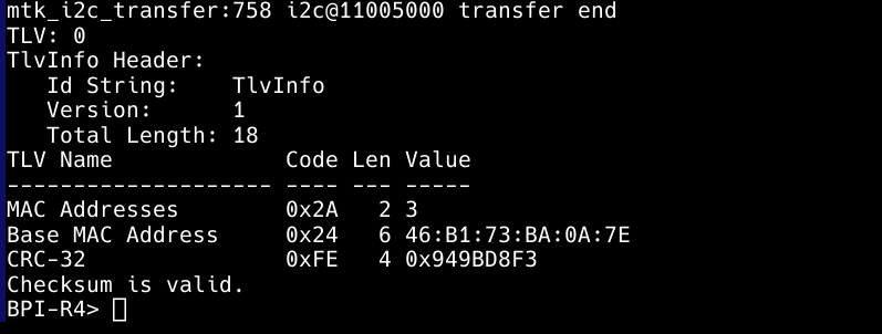

BPI-R4: u-boot: i2c
But if mac address is first
all works correctly

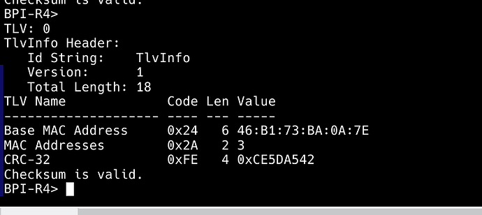

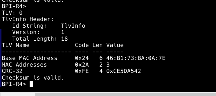

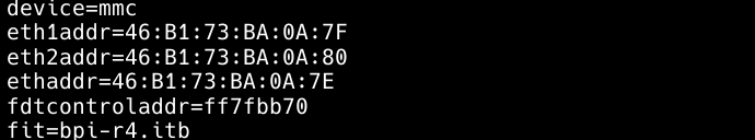

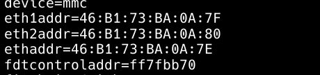

I’m fix this error.
I read the values ​​incorrectly.
tlv_eeprom_fix_read.patch (2,6 КБ)
Now it’s work correctly

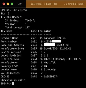

BPI-R4> tlv_eeprom
TLV: 0
TlvInfo Header:
   Id String:    TlvInfo
   Version:      1
   Total Length: 18
TLV Name             Code Len Value
MAC Addresses        0x2A   2 3
Base MAC Address     0x24   6 F2:B8:7B:4D:00:01
CRC-32               0xFE   4 0x75E88454
Checksum is valid.

have reverted the tlv-code patch and just enabled the ID_EEPROM option and chainloaded uboot from my existing
CONFIG_SYS_EEPROM_BUS_NUM=0
It is the default in stock OpenWrt Snapshot.
