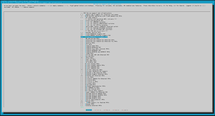

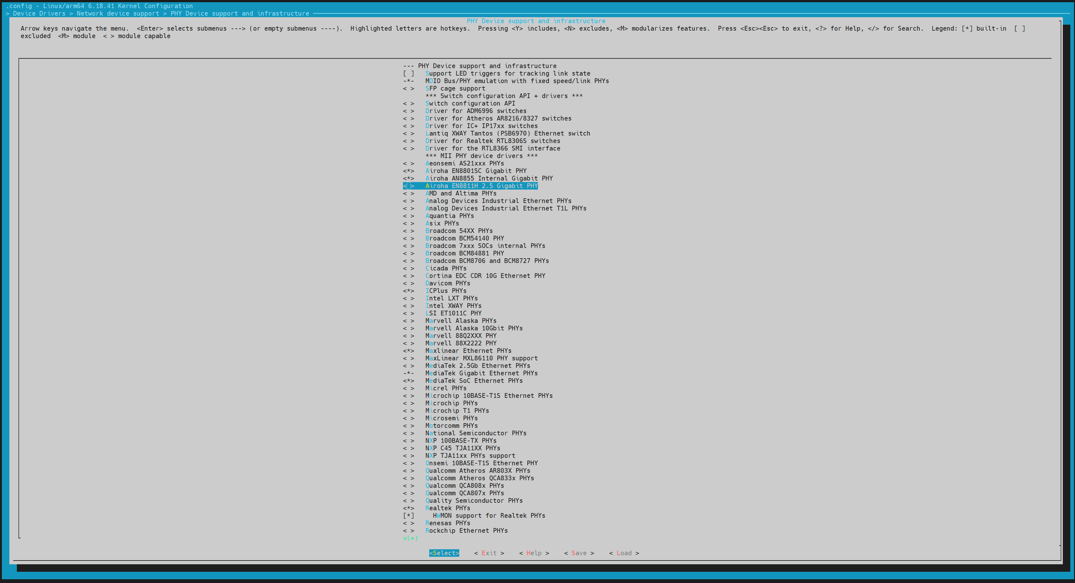

Ai write that i need install: Airoha EN8811H PHY support
make kernel_menuconfig
go to
Device Drivers -> Network device support -> PHY Device support and infrastructure
select
Airoha EN8811H PHY support (*)
I check make kernel_menuconfig And i not selected it,

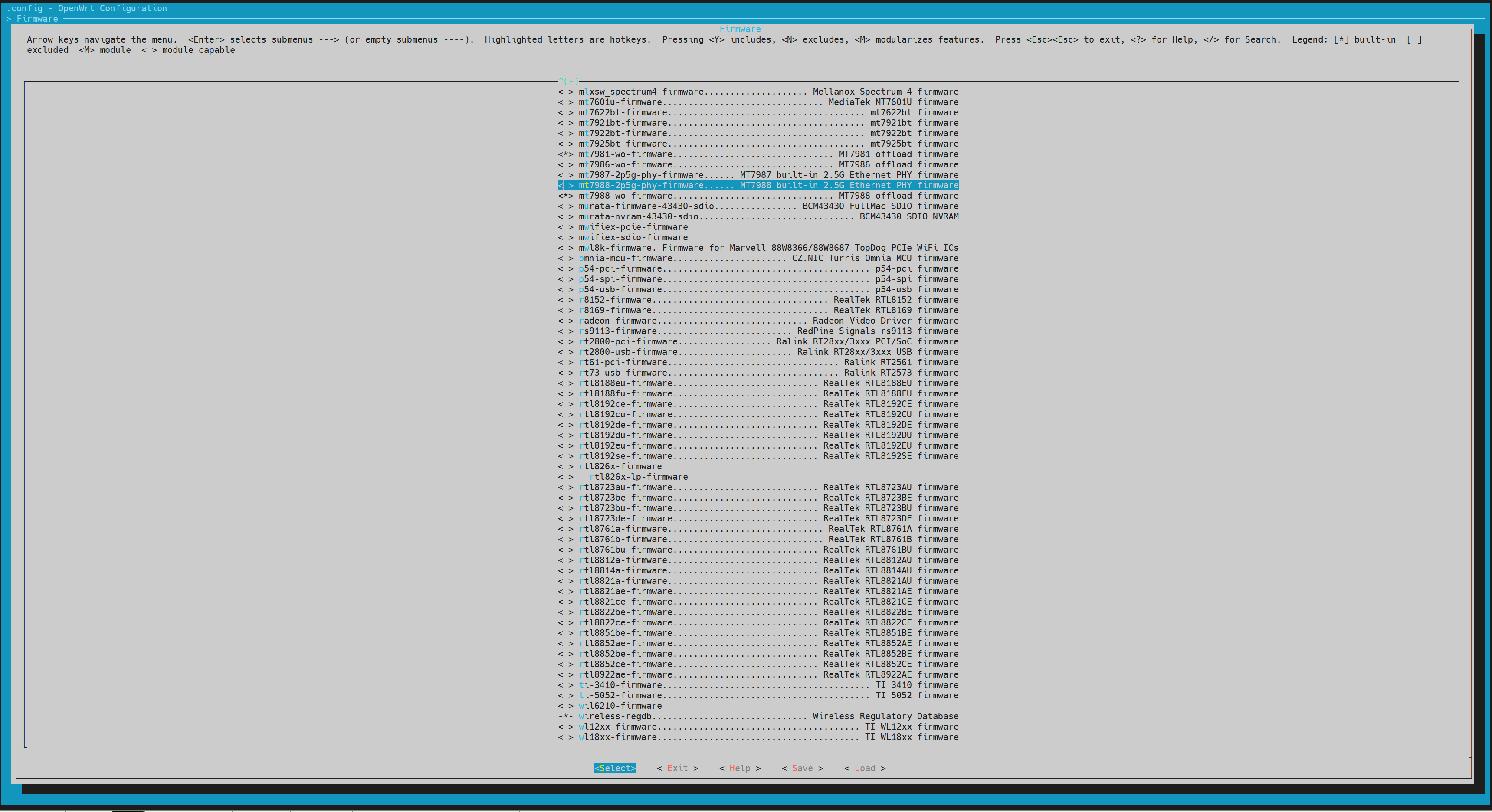

It works. @frank-w thx
make menuconfig / Firmware / [*] mt7988-2p5g-phy-firmware
[*] mt7988-2p5g-phy-firmware… MT7988 built-in 2.5G Ethernet PHY firmware
