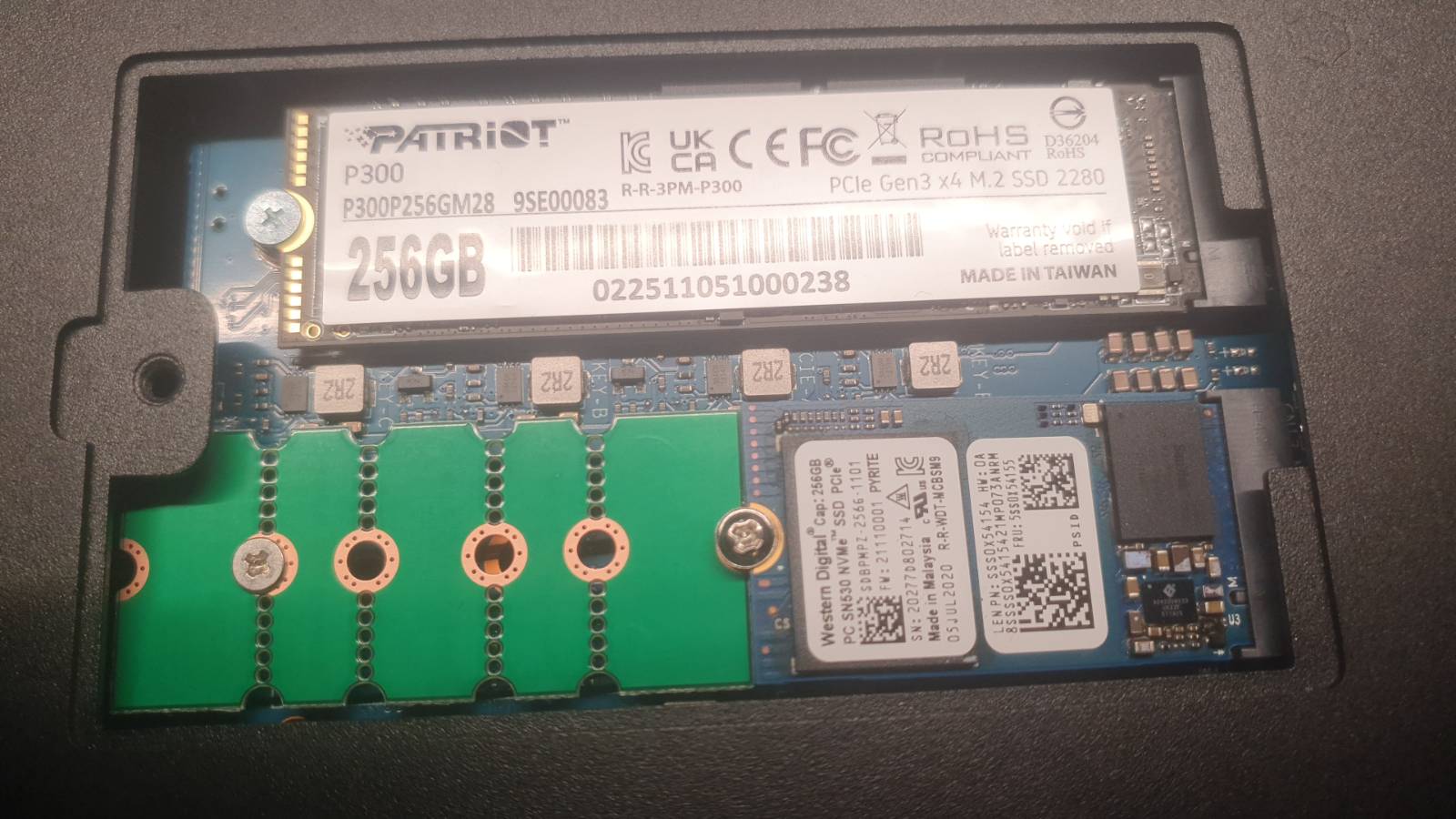

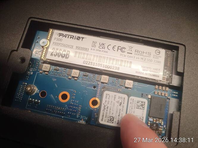

Hey guys what screw do I need to use this ssd? How can I move the standoff without damaging the board? Maybe its better to get just another standoff then I can use the M.2 screw? Do we have dimensions of the possible standoff screw? Or better to buy a 2230 to 2280 adapter?
https://www.amazon.com/Mounting-Screws-Gigabyte-ASRock-Motherboards/dp/B08ZD81HDR/ref=sr_1_5
this one the screws heads are to slim. I found something similar on amazon.de but the hole is big and the head should not be too tall. I don’t see any groves in the motherboard. 633 Stück Laptop Schrauben, M.2 NVMe SSD Montage Schrauben Set, M2 M2.5 M3 Notebook Computer Schraubenset mit Schraubendreher für Asus Gigabyte MSI-Motherboards, Kompatibel mit IBM/HP/Dell/Samsung : Amazon.de: Computer & Zubehör
It seems like the simplest and fastest solution. You could also 3D print it—maybe one of your friends has a 3D printer.

Yes, this worked. it is a bit lose but the OS can see it :+1:
