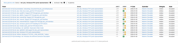

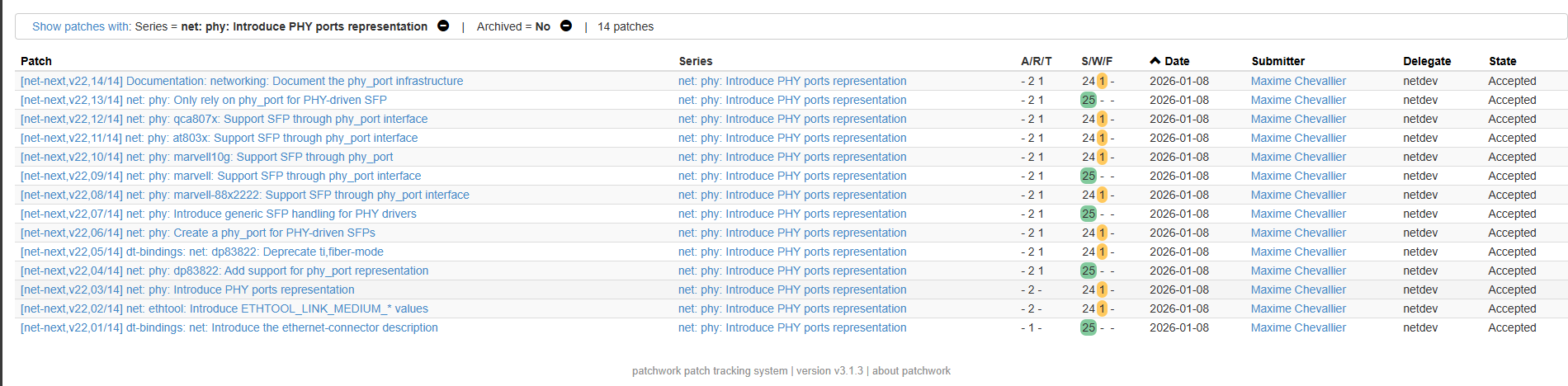

may it be this?
Diff - d16549a1a59d5a93ee5c0011d36f758c11f59773^! - openwrt/feeds/mtk-openwrt-feeds - Gitiles
interesting thing is that the MXL switch ignores that so i believe for the lan aeonsemi to work correctly we need a good driver from dango.
Hey guys, If I install the current OpenWrt image from this page, will I be able to upgrade later to the official release using the system upgrade option in the UI?
as its based on openwrt, there should be no problem in doing so
@frank-w finally :smiley:
Wow,yesterday it was still new,but got some missing reviews by andrew.
It is only the first step for ethmux (which is last step)…not sure if there is any code supporting ethmux based on it.
