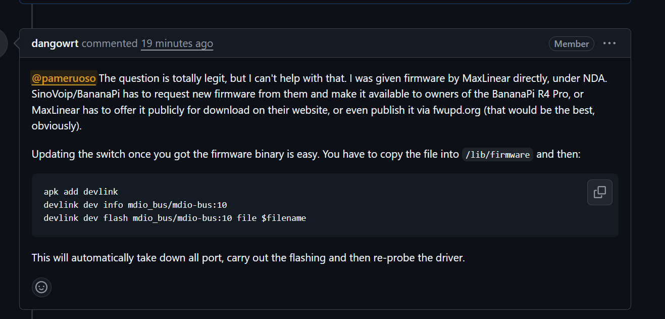

Daniel told me that downstream driver should not merged to openwrt and he should finish upstream driver soon to add this to openwrt instead.
In the meantime i try to get R4Pro working with 7.0 where i experienced some issues (mxl switch detected,but no traffic,ethmux broken+reverted for now,phy not tested yet).
kernel: add DSA driver for MaxLinear MxL862xx switches by dangowrt · Pull Request #22612 · openwrt/openwrt
@frank-w what is the plan for the 1.0.78 firmware… it is not clear to me if it will be released or buildt completely from dango?
I still use 1.0.70 and not yet done a firmware update yet (other firmwares are currently under nda),only got some information from daniel about this. We can only wait till maxlinear releases an offical firmware ot test with current installed version. Latest patches work so far (7.0-mxl branch in my repo),only noticed an issue with software bridge which could be caused by my outdated firnware. But i have not done extenaive tests yet,only bootup basic ip assignment on sw bridge (which does not get traffic),removed bridge and put ip on interface directly (worked so far). No iperf,vlan or similar yet.
now that the driver is merged and the statement from Daniel is very clear… at least the 1.0.78 is needed… I am wondering if @sinovoip as vendor of the rourter itself is in charge/available to provide the 1.0.78 firmware for ppl that bought the board. @sinovoip1
@sinovoip @sinovoip1 what is the status on firmware 1.0.78. I have a router sitting here that I purchased from you and it is essentially useless without the firmware.
Also looking for the latest firmware version for the MXL 2.5g switch.
Dear Manufacturer,
As a customer, we require a new version for the switch. We kindly ask you to provide it.
