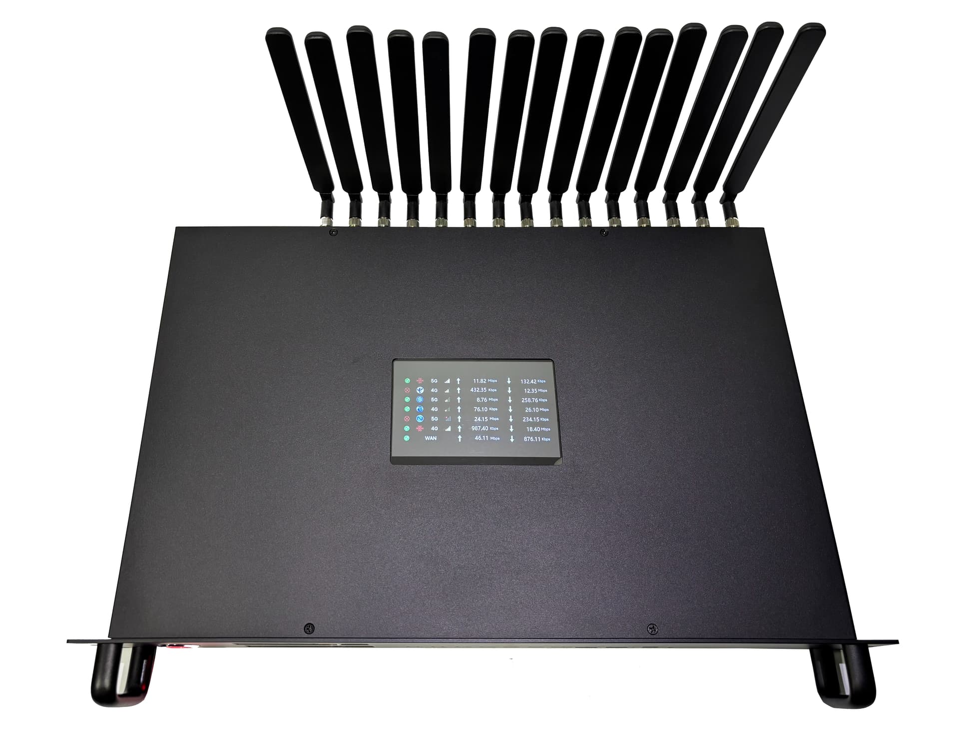

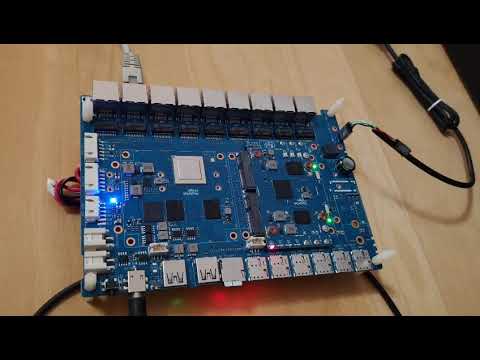

5G gateway base on Banana Pi BPI-R4 , Mediatek MT7988 chip design, all hardware function test ok.

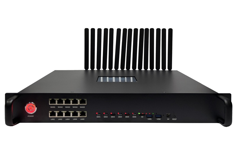

product design for OEM&ODM.
https://www.aixiaocao.com/en/single-board-computer/105.html

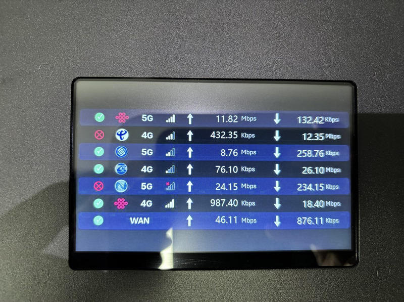

MNF-PRO intelligent 5G multi-link aggregation is a multi-network convergence communication technology based on operator wireless links. It provides stable and high-bandwidth wireless transmission for people in outdoor/mobile/non-fixed network scenarios, especially suitable for high-definition video transmission. At the same time, this technology also provides a solution for some special application scenarios. Currently, with the increasing application of high-definition video in various industries, related demands are rapidly growing.
Equipped with an aggregation communication core algorithm, it supports dynamic real-time detection of link bandwidth. Utilizing industrial-grade motherboards and modules, it offers stability and efficiency, meeting the requirements of practical application environments. The fully integrated motherboard design (as opposed to a core development board + expansion board) ensures shock resistance and stability of the motherboard when in a mobile state. The motherboard configuration includes: quad-core MT7988A, 4GB DDR4 RAM, and 8GB eMMC;
