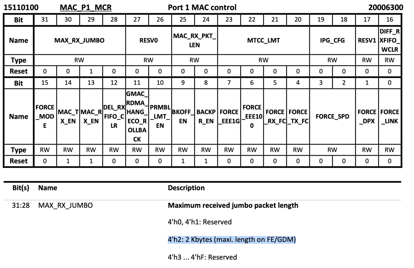

for gigabit ports It’s a hardware limitation for gigabit ports (mentioned in datasheet) for USXGMII ports (10G , 2.5G) - it is mentioned that it is possible to have up to 15k frames , but simple setting controllers registers to use frames larger than 2k in driver leads to frames drops for frames larger than 2k , which means that some additional setup (like ring byffers adjustment, DMA tranfers setup etc.) is missing and needs to be done to actually support jumbo frames. Also , worth mentioning that using frames larger than 2k may be incompatible with some hardware accelerations
My response may help to add 9k support
But possibly (like valentin wrote) it breaks other parts.
Ictually , I’ve tried this patch and it doesn’t work out of the box , setting mtu to anything > 2k leads to broken reception
Ok,but youve tested without rss/lro so far…directly on ethernet driver and with mac (eth1,eth2),not switch.
for gmac and FE the MTU is limited by MAC MCR registers
2k is maximal MTU , anything more you set will be ignored so there is no point at all to use anything more than 2k on gigabit ports

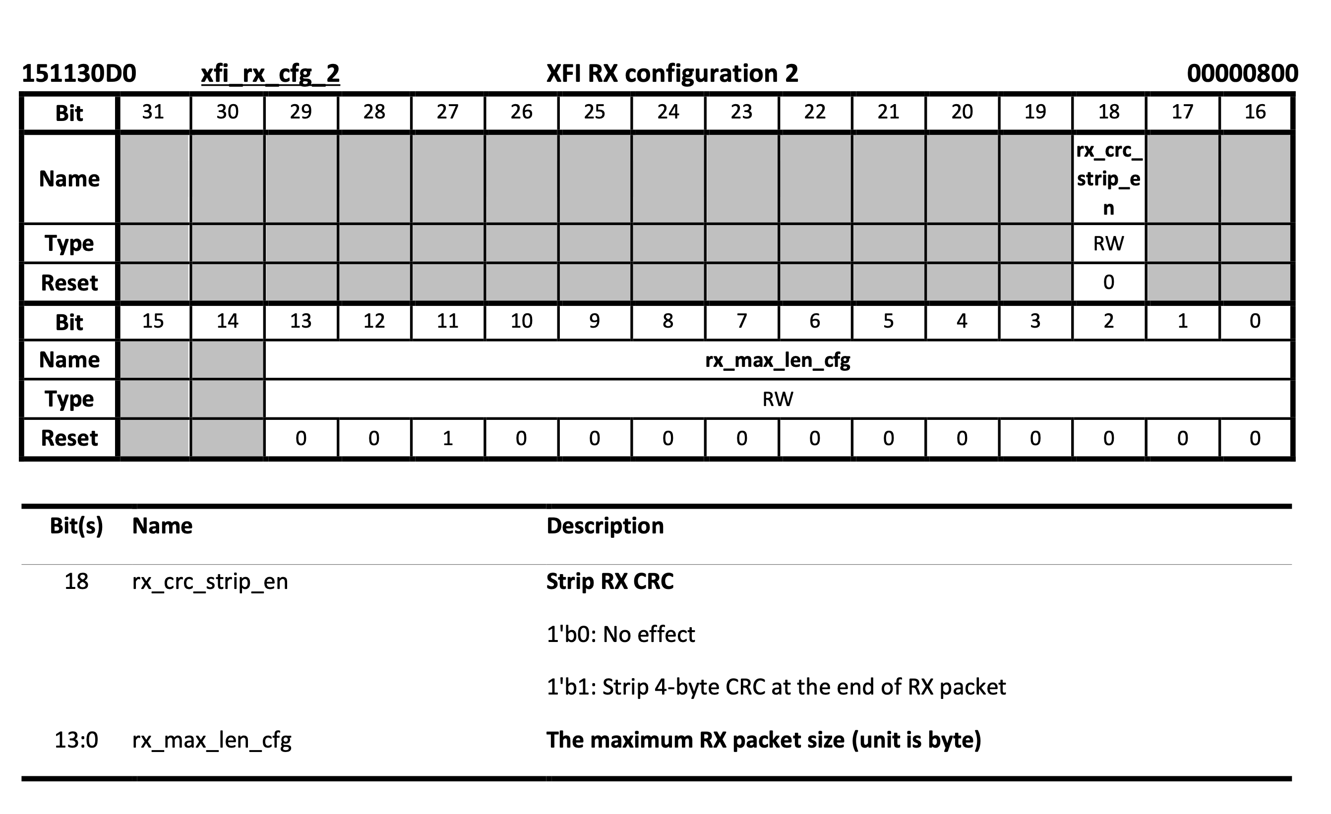

in other hand for XFI Mac interfaces you have a different register for packet size configuration
which lets you to set upto 16k packet MTU
I’ve tested with and without rss/lro and only for XFI interfaces , no matter what is selected , as soon as MTU goes over 2022 - all frames are dropped. I believe that getting JUMBO frames working even without rss/lro makes sense , because it reduces overal interrupts count

@frank-w it’s different but it uses same MTK_XMAC_RX_CFG2 register and MTU size function uses mtk_interface_mode_is_xgmii check (only for 10G MAC’s ) to allow 9K MTU - so larger MTU is applicable only to 10G ports
