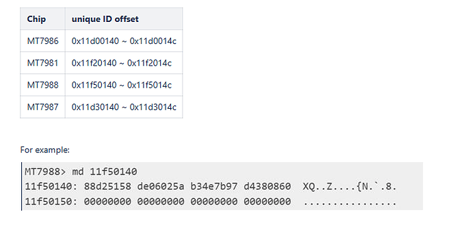

You can try to read register from 0x11d00140~0x11d00144. it’s a unique id of the chip

Hy Thank you. I will truc tonight. You use thé command Line MD from uboot?
In your screenshot and also checking various devices with the same SoC it looks like there are 8 bytes unique ID and not just 4. @moore can you check and let us know what the adjacent 4 bytes 0x11d00144~0x11d00148 are and if they are also a unique ID or something else?
Correct my previous information: The total bytes of the unique ID is 16 bytes.
On MT7981, MT7988 and MT7987 the ID seems to be 16 bytes like you described.
On MT7622 and MT7986 I only see the bytes 0x140~0x148 in the efuse resemble a unique ID while 0x148~014c are all zero. Can you check again for those older chips please (MT7622 and MT7986)?
Edit, just for completeness: MT7623 doesn’t seem to have any unique ID in the efuse (dumped on BananaPi R2).
Thank you for your reminder. After checking the datasheet, I found that the unique ID for MT7986/22 is only 8 bytes.
