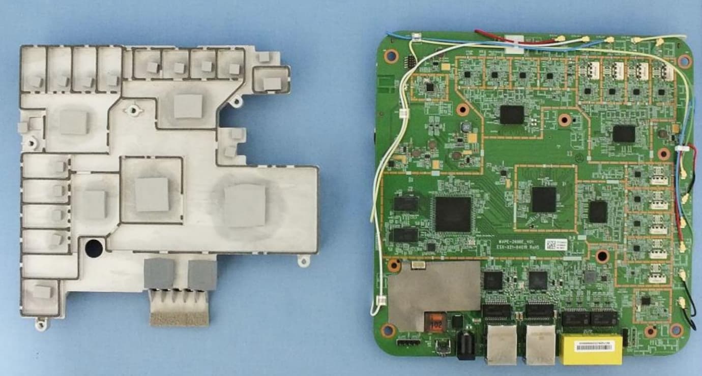

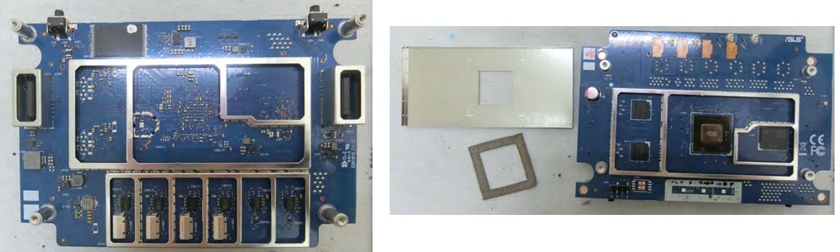

But I did not see any shielding or cooling. How much time will it take for OpenWrt to get full support … ?
I see tracks where the shields should be soldered. I really hope that there is no shielding in the photo to clearly show what is soldered on the board. Because if you take a photo of a board with shielding, you will see just a metal plate with several protruding elements, this is not very impressive.
I see two possible approaches for shielding and cooling:
However, the R4 Lite is already on the market, and it doesn’t include any shielding or cooling in the package. The board itself clearly has options for adding shielding, though.

If I had to guess which product will become stable first, my bet would be on the R4 Pro rather than the BE19. But buying one within the next year will be for those who are willing to tackle both mechanical and software challenges. And even then, success isn’t guaranteed.
I liked the shielding as in the first photo (green board) more. I’m waiting for R4 pro and BE19. Why am I focused on the release date? Because I want to know how soon the R4 pro + BE19 bundle will be released, and if the term is too long for me, I will look for another manufacturer, if not, I will wait.
I really hope that R4 pro and be19 will have decent shielding, I emphasize - not some formal one, but a very good one. Otherwise, we will get another garbage product with a lot of noise, because of which it will be impossible to use the device. After all, the R4 pro + BE19 bundle is very serious, and errors like the lack of shielding are simply ridiculously disgusting.
This is exactly what I am not happy with. If a manufacturer produces a serious device, for a lot of money with capabilities for corporate-level tasks, then this device MUST meet this level. Personally, I can wait until the software for the device is finalized, but it is completely unacceptable if the device is physically faulty. And if the manufacturer, instead of a recall campaign or at least helping to reduce the problems, simply closes its eyes to the problems, then this is a VERY bad manufacturer. What is being sold is not a toy/constructor, but a device with clearly stated characteristics, and BE14 does not meet the characteristics at all. Therefore R4 pro + BE19 will be the last chance for banana pi, if it turns out to be as problematic as BE14, then I will permanently delete all chat history and log out of my account on this site and will never touch banana pi products again, and I will advise all my friends to avoid this company.
