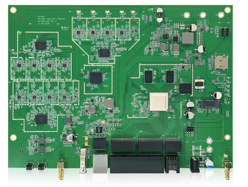

I found the sibling of Banana Pi’s BE19 on AsiaRF:
grafik
grafik
sample ready:

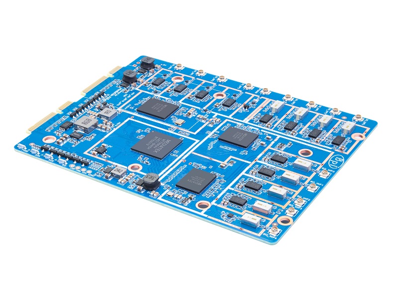

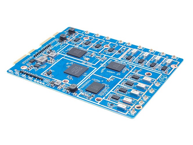

Very good. I surely believe there are many others than just me waiting to see, if this would complete “the best WLAN access point/router available”. Because others than BE14 range issues, I still believe this is.
I don’t see a shield for it, had the noise issues of be1400 been solved with the be1900
I’m absolutely certain this is yet another piece of e-waste. As much as I don’t want to believe it, there’s a high chance something’s wrong again — and it’s all because this is a “development board”!
The BPI-R4’s CPU frequency is way too low. At a similar price point, the ASUS RT-BE88U is powered by a powerful quad-core 2.6 GHz CPU!!!
Looks like provision for the shielding, though? the edge lines do look like they are present. Would there be the shielding on already (on such speculated lines) the photograph would have very little to show.
Are you sure that Cortex-B53@2.6ghz (custom version of A53) surpasses Cortex-A73@1.8ghz?
Yeah there’s markings for shielding which the be1400 also had but didn’t really improve the noise at all from other people testing
Not necessarily mere markings - should be the actual ground plane the shields attach to (via soldering).
Impossible to say for sure, of course, from just that picture.
If they are, this will, of course, yield better shielding than just having metal plates.
Yeah I just forgot they were called, but no one is sure if it’s actually connected to ground plane due to the lack schematics

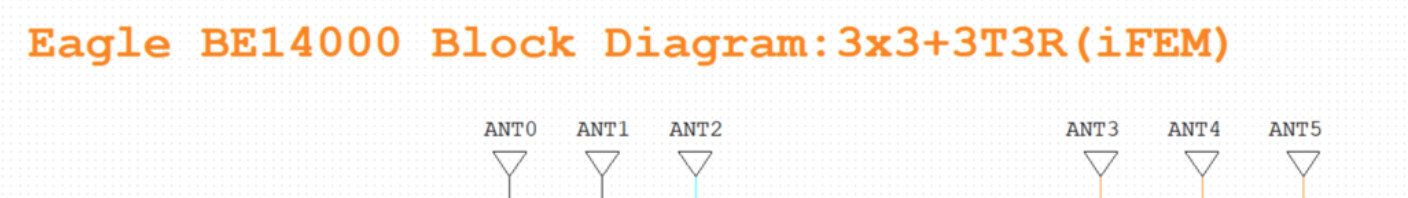

The BE14 was described as an iFEM and had no shielding soldered:

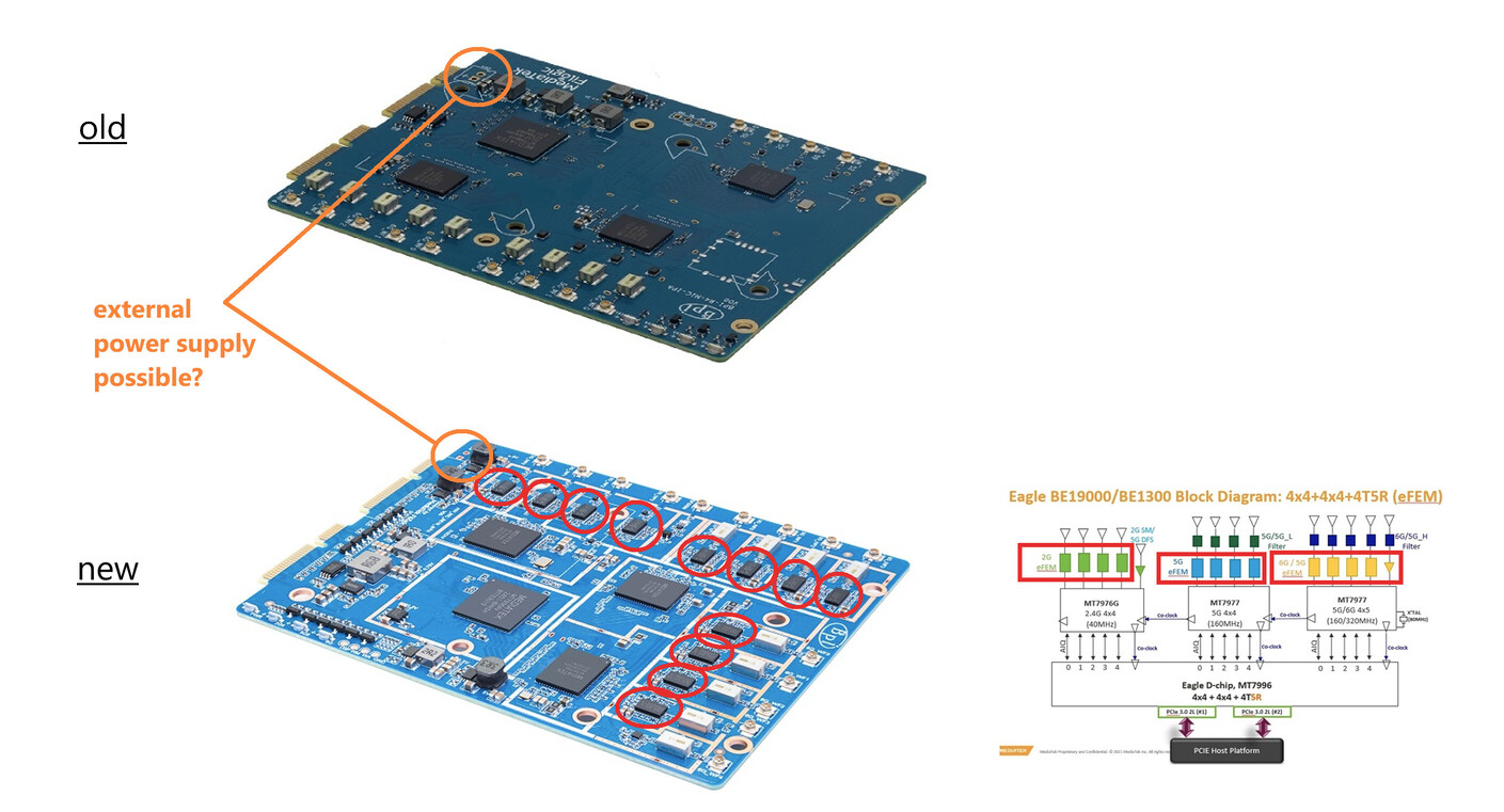

Congratulations:
You changed your opinion :slightly_smiling_face: and redesigned the BE19.
eFEM
  • Now there’s a really big eFEM on the board — it even looks larger than the ones from AsiaRF :cowboy_hat_face:.
Shielding
  • Much more improved — and now separated! :+1:
External power supply
  • Did I see it right — is external powering possible?

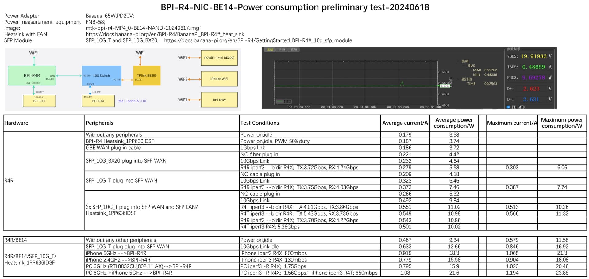

Power consumption
  • As always, I’d be very interested in the power consumption:
    • Max
    • Idle
    • 2.4 GHz only
    • 5 GHz only
    • 5/6 GHz only
  • That info would be really helpful! For comparing BE14 and BE19.
    like this:
